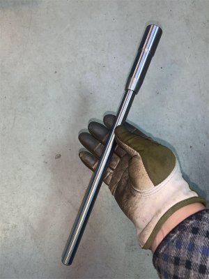

今天买了一个内冲工具,做了一个17mm的套筒来测试。
I bought an internal punch tool today and made a 17mm sleeve for testing.
打一个孔并压一个 15mm 的轴。
Drill a hole and press a 15mm shaft
然后将其焊接在一起。
Then weld it together
高温弯曲。
High temperature bending.
高温淬火。
High temperature quenching
成功地减少了巨大的间隙摆动。
Successfully reduced huge gap swing.

I think it is about the reason of being particularly busy recently :1. The quality of the rotary stamping handle purchased is very poor, and only one hexagonal tool is made after the end of life. 2. I used the MT40 taper shank of my own 25 straight shank rotary stamping, but also because there is no plane support bearing inside, it was soon scrapped. 3. For the above two reasons, I had to choose to make my own rotary knife handle. 4. And I am trying hydraulic stamping simultaneously, which also needs to make some tooling and fixtures. 5. I even bought a punch grinder (used) and then spent a lot of time repairing the grinder first and replacing the fixture of the grinder. I want some tools that can perfectly make inner polygons. Whether it is rotary punching or hydraulic punching, this is a new field that requires a lot of time and effort.

@a smile Sun with your EDM you could cut out the internal hex shape. You are not doing that. I’m sure you have good reasons - is it not practical? I don’t have an EDM so it is hard to see why.
EDM is not used for two reasons: 1.EDM cannot process blind holes. 2. I need to produce a large quantity, and the efficiency of EDM is very low. This little tool is not suitable for using it. 3. I have successfully made the rotary offset shank, and I have successfully made some inner six holes (blind holes).
