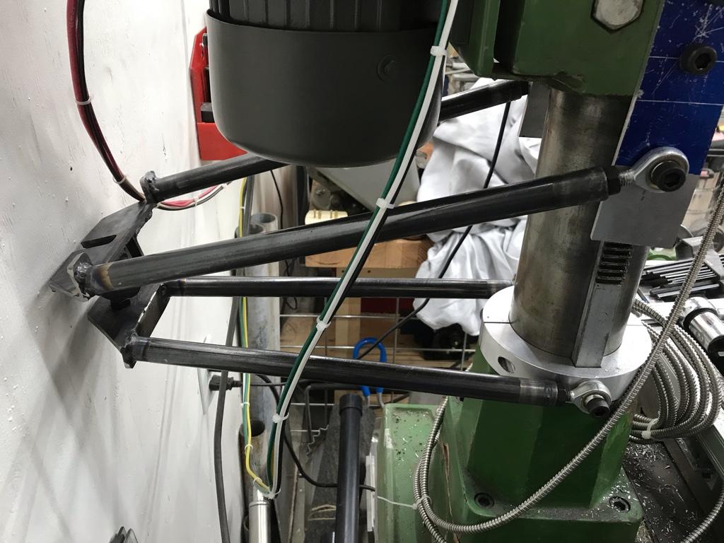

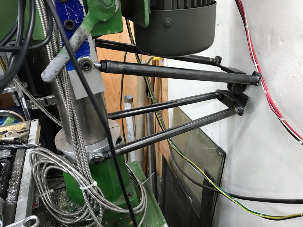

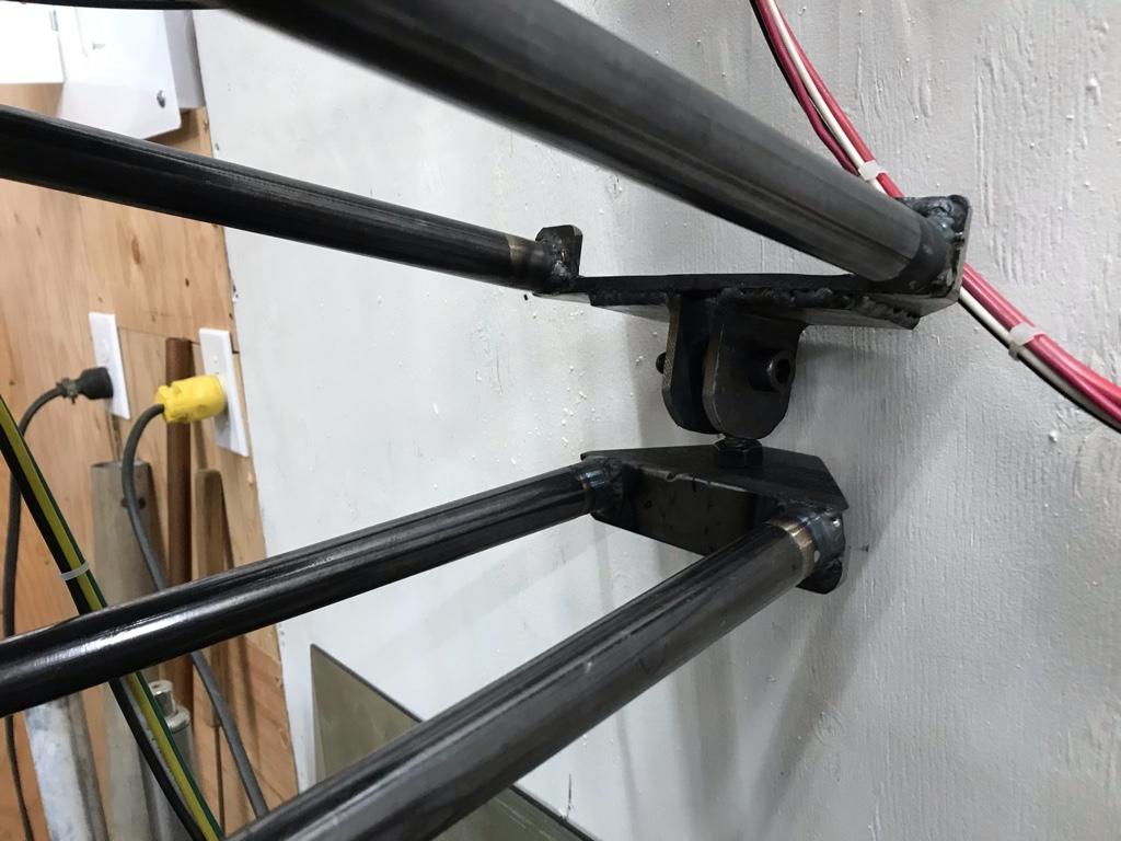

I built a set of arms, that function like paralevers. Using ball joints one set of arms is connected to a collar on the base, the other set is connected to the head with ball joints. Both sets are hinged together using ball joints.
It looks like it's connected to the wall but it is free floating.

It works really well.
I spent some time trying to measure how capable this guide is at returning the head to the same location.
My process was this:
Raised the head to a height where quill could be fully extended plus another four inches.
Put a mag base with a thousandth's indicator to the right of the quill.
Extended the quill only as much as necessary to get the stem of the indicator against the quill.
Moved the X-axis till the indicator made contact.
Moved the Y-axis back and forth till I found the high point of the diameter of the quill similar to dialing in a 4-jaw chuck.
Zeroed the dial.
Fully extended the quill.
Locked the X and Y axis.
Raised the head to the maximum height while still making contact with the indicator. While cranking the handle the needle swung about 20 thou but settled back down when I stopped cranking.
Tightened the head bolts
The quill was within 1/2-3/4 of a tick off zero.
Slacked the head bolts and dropped the head to the lowest point possible.
Re-tightened the head bolts with the same result.
I snugged up the jam nuts on all of the ball joints and that reduced the deviation to about a needle's width off zero
I did notice that when cranking the head up (less so down) that the angle iron at the hinge was flexing maybe 1/8"-1/4". I think some additional lateral bracing would stop the flexing and likely any movement while cranking.

I still need to add the additional bracing I’m very happy with it.
I’d love to take credit for it but it’s not my original idea. I copied a build off of Hobby-Machinist.
