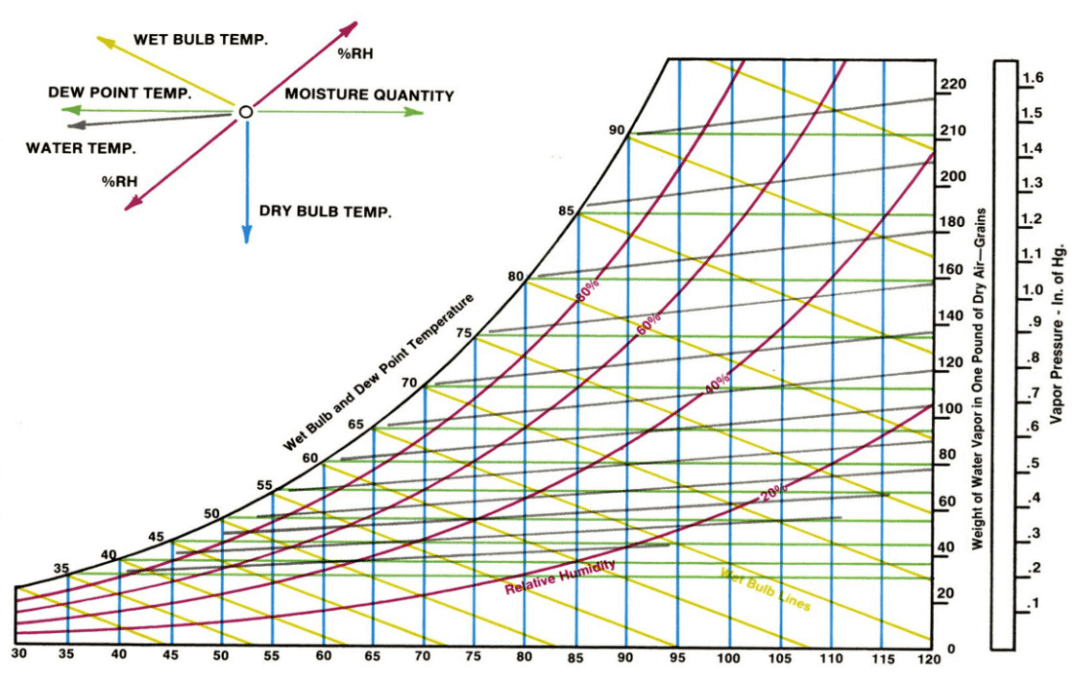

Start with 25C and 45% RH and raise temperature to 50C and RH drops to 11.55% plus the air has expanded a bit. Thing is, if I understand this correctly, the air and water molecules inside the filament are still really at the 45% RH level. Over time at 50C they migrate out to ambient bringing the RH inside the filament down to closer to that 11.55%.
Now when it goes into the nozzle for printing and is brought up to 205C there's much less moisture to snap crackle and pop making the resultant print much smoother.

You have the gist of it John. Close enough as they say. But the psychometric chart has other tricks up its sleeve. You chose 20 and 50. But - 5 and 20 are more realistic for this part of Canada. Your link calculates dew point. I was going to provide a link to psychometric chart which is somewhat complicated to use, but in the process I found this one which does exactly what we are after. Plugging in an outside temp of -5C, an outside humidity of 45%, and an inside temp of 20C we see that the relative humidity inside dives to just 9% inside.

I think most people separate humidity, corrosion, dessicants, dehumidifiers, dew point, and soggy filaments as though they were each a unique process, when they are not. It's all about how much water a given volume of air can hold at a given pressure and temperature. The amount of water in there vs the maximum amount of water that could be in there is the percent relative humidity. The lower the percent, the drier the air and vice versa. It's all defined very precisely by psychometric charts like this one:
Or this one from one of my many engineering thermodynamics text books.
In this case regarding filament storage and filament dryers. It's a fair bit simpler.
Basically, if the goal is the driest filament possible, then dessicating it should be done at higher temperatures, with low relative humidity established by a dehumidifier.
If the goal is storing it and keeping it dry assuming its already dry, then one of many good alternatives is to just put it into a water tight container filled with cold dry air. This can be easily done by putting the filament into a sealable box and then scooping some cold outside air into the container or even dunking it into a floor chest freezer to let cold air spill into the container. Close the lid but not too tightly, then set it on the shelf in your work area to let the air temperature stabilize. Then seal the lid solidly till you need some filament. Rinse and repeat as you need more filament.
The idea is to take advantage of the fact that cold air holds very little moisture, and as it warms up, the relative humidity will dive.
Of course, as air warms, it also expands so the lid can't be sealed tight until it is warmed up enough that it won't burst. The air leaving the container does no harm and actually serves to leak a little water too.
