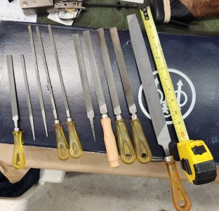

I just picked up a handful of nicholson files from Quest Industrial in Calgary (Whom I love, the staff there are so helpful and friendly). They were 12-15$ a piece, and I'm not expecting too much out of them as I've read all new nicholson files are now the poor quality, economic option since outsourcing their production, but I really need them for a weekend project. After purchasing however, I realized 3 of the 5 files are stamped with a made in usa on the tang. Is it possible these are NOS and might actually be good?? Only time will tell LOL.
As an aside, I was pleasantly surprised to discover Quest has lathe files as a regularly stocked item (45 degree cutting angle, no teeth on sides of file (safety edges)).

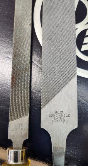

I call those sideless files "lathe files". I know there is prolly more to it than that, but in my ignorance, that's what I call em. Love to know enough more to use the name correctly.
Pillar files fo not have teeth on their edges. They are parrallel in width, slimmer than standard files. Designed more for delicate work. Generally swiss pattern double cut in 00, 0, 1, 2, 4, 6. I think 4", 6", 8" in length, and in several widths. And good ones, Nicholson, or Grobet are expensive.
Lathe file has single row teeth at a 45°angle, and much larger. Lathe file shears the metal when filing on the lathe producing a better finish.
So both lathe and pillar have smooth sides, but lathe is bigger and only has single 45 degree blades while pillar is smaller and cross hatched?
