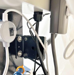

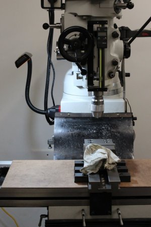

I have this one (unfortunately no longer available on Amazon) mounted on my Mini-Mill:
I chose it specifically because it didn't have a magnetic base; instead it's attached to the back of the column:

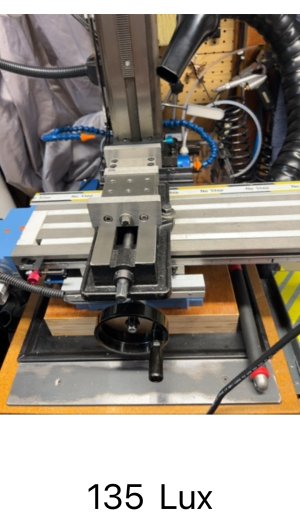

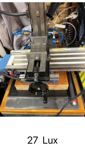

I also have a small magnetic "Sewing Machine" lamp that helps eliminate shadows. However, since I added a FEIT 46" (4' class?) LED Shop light (Costco) above the mill, I don't have many shadows anymore:
Before:
After:
{measurements at the table surface)
I have something similar to this for troubleshooting work like under a hood. They are quite good. Which makes me think an array of LEDS in that kind of form factcor (vs more concentrated array like modern flashlights) would make a better work like for a machine.
It's fine and for $25 I don't mind having it on hand. But I'll definitely pick up something more robust later.
Before:
After:

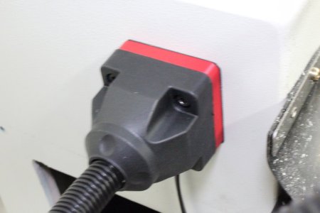

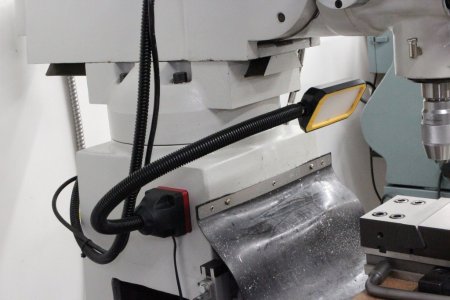

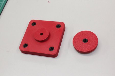

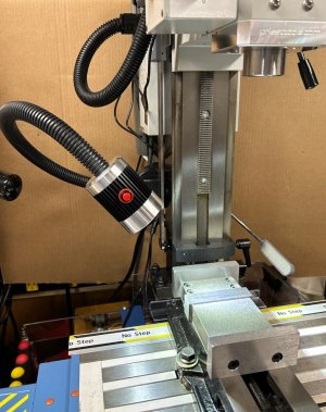

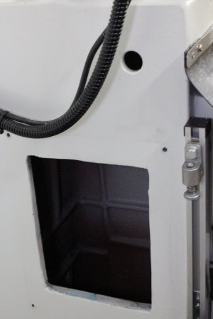

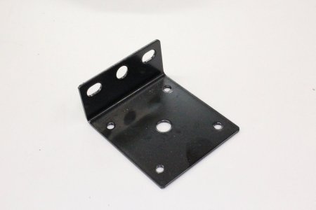

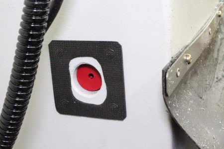

The AliExpress LED lamp arrived. I'm quite pleased with it. It came with a mounting plate but I thought I'd try & use the existing hole in the column. It has a removale panel so you can reach inside to hole a retention but. A few 3DP parts & thin gasket later. You can see how the lamp tucks up under the head out of the way for the post part. Its pretty bright (and non-dimmable) but just adjusting the angle removes the bad glare. Similarly can just grab the head & point it to a nook or cranny if that swhats required. The goosneck is nice & stiff. So I guess put it to work & see how it goes.

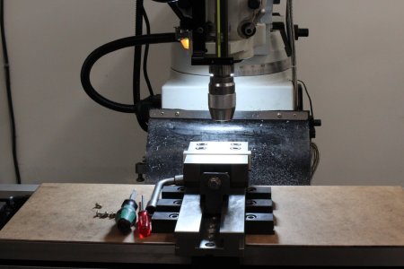

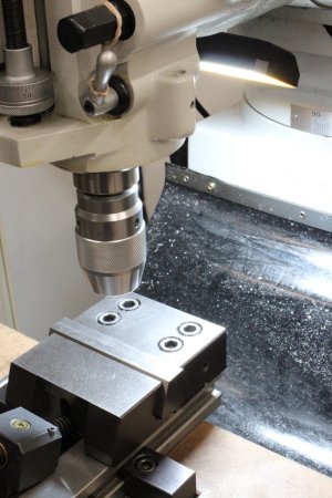

@BaronJ wins the 'I told you so' award. After a few hours work, the brightness finally got to me when I had the lamp head more or less centered, tucked under the mill head. More specifically, the reflection off the vise & table got to me. The 1mm thick diffusion filter plastic I had on hand blocked too much light & would hav ebeen a pain to mount anyway. So I just moved the lamp head over to the side & bit further away so it casts from left to right vs. bouncing into my eyes. This is a huge improvement, still very well lit but no more welder flare 😳 The gooseneck is not really in the way of anything I do on that side.
