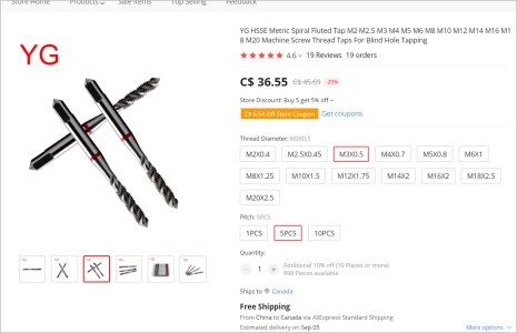

Same as these? ($19 including shipping) ??
https://www.aliexpress.com/item/32869022176.html?
In my very limited experience, I've found that the 'bargain basement' tooling from China isn't very good/dependable (mis-ground drills, mis-sized drills, and a couple of taps that didn't seem to cut well) but the better stuff on AliExpress performs well for me. Up to dozens of holes so far and the taps are holding up well! :) (I'm much more likely to break taps through bad technique rather than wear them out.)
I like Sowa taps a lot & I do a lot of aluminum. Actually even their coated ones intended for steel work fine but I always use fluid.
I'm not as impressed with the cheaper offerings. They are generally not as sharp or true & that's what gets you into trouble.
On Ali & Ebay I see some YG in larger (same size) package quantities but I just cant see myself using 10 so I have passed. But as a brand, they are very good.

accusize HSS M3 taps. 10 pack for $30.
I generally need them for tapping aluminium.
Anybody try these from Accusize? I tend to break them so 10 of them is appealing as is the per unit price. Any good?
Or would one good tap from Sowa or another credible tooling manufacturer be as good as 10 of these?
