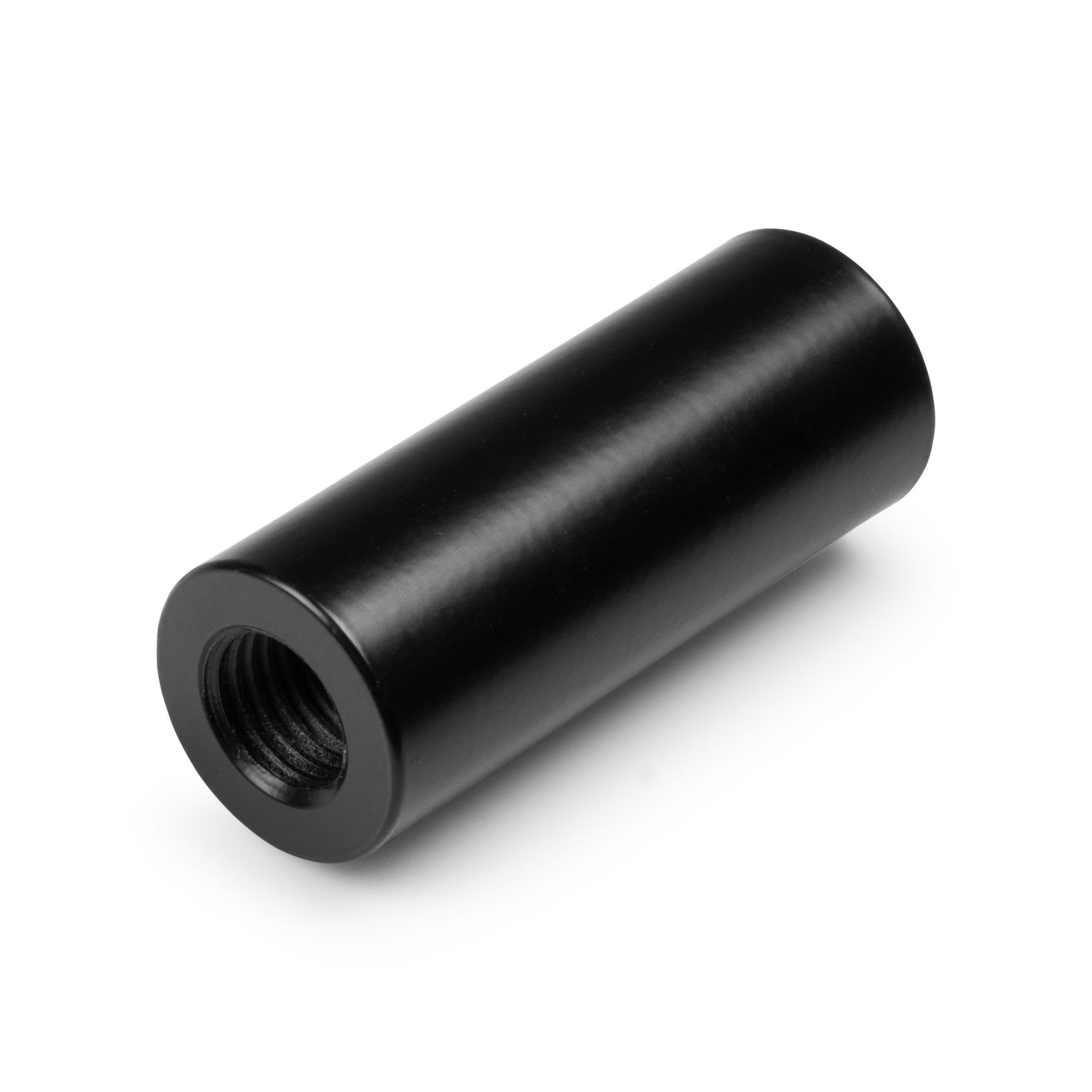

Basically need to make some of these:
I actually have a set of these exact ones that came with my Gator poles, but I don't like the loose fit in some new subs I got and want to make a set with the OD slightly larger and a very very slight taper. Short term I can wrap with electrical tape to snug it up, but that's not ideal.

Not tapered threads, taper of the body of that insert so it fits more snugly in the pole socket (the pole socket also has a slight taper).
