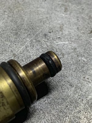

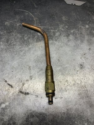

I noticed the other day that all the O rings on the tips for my Oxy/Acet are starting to get crunchy, I went to Cancarb the welding shop I use the most but they couldn't help me.
Anyone know where I might try next? I'm assuming the material for the O rings must be some kind of special compound to handle Acetylene?

Not my field of expertise, but acetylene is just a HC gas. So I think most of the common ones will work. For example, Nitrile, EPDM, fluorocarbon, and neoprene should all work fine. PTFE is prolly good too.
I bought a couple of o-ring assortments off Amazon, relatively cheap and have found them very useful. (Granted, I do a lot of mucking-about with valves and pipe fittings). The silicon ones are quite soft, the rubber ones are likely what is used on your torch.
