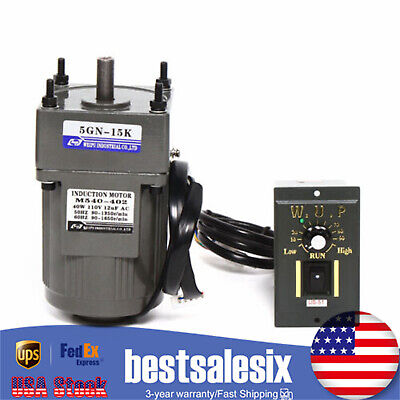

OR something like this?

The low speed motor in Post #6 is what I was thinking as well, actually cheaper than some of the Aliexpress versions. I noticed some of the control boxes had reverse & others did not so best to verify
