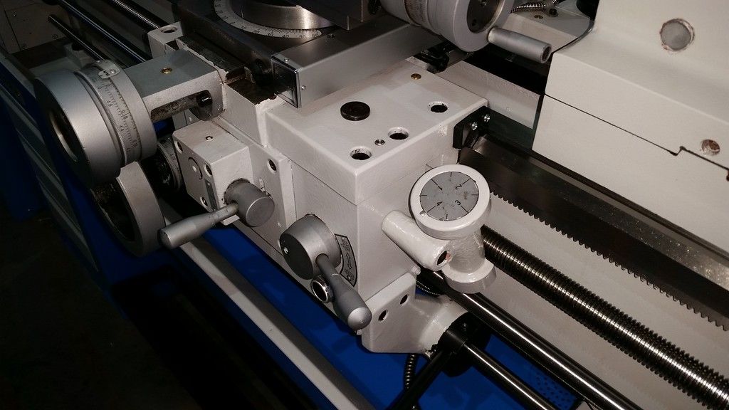

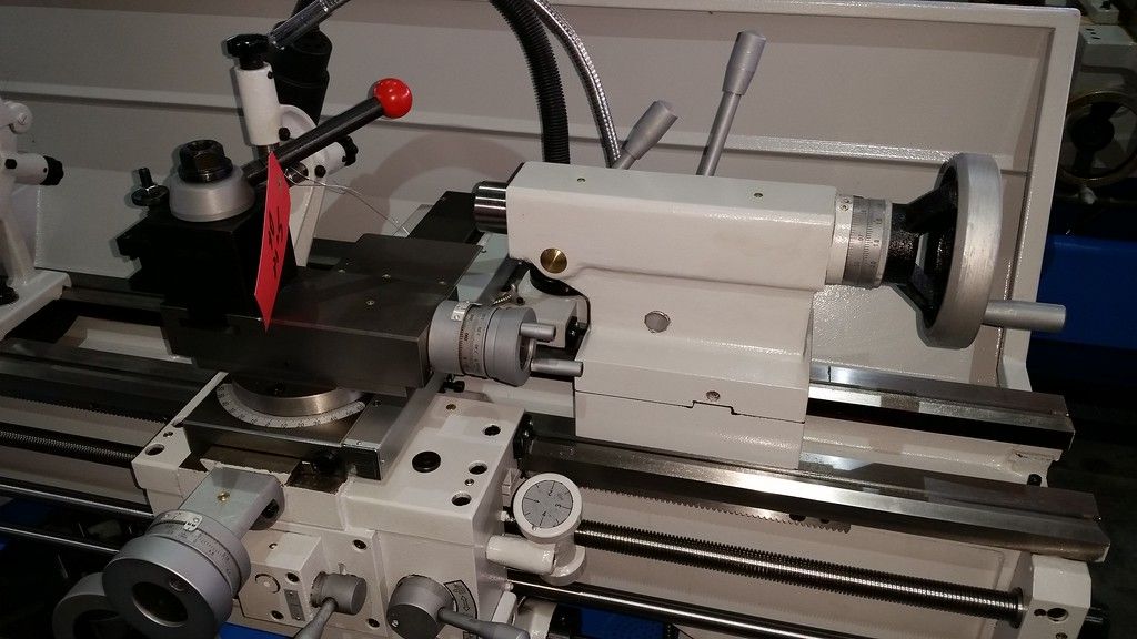

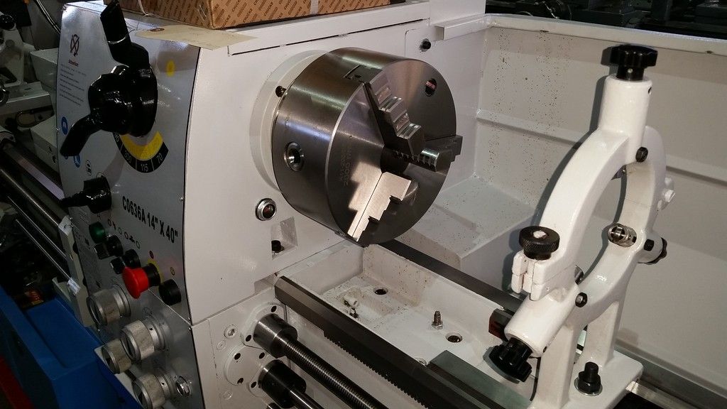

I was in Modern's show room recently and took some pictures of the C036A 14 X 40. This model has had some upgrade in the past year and now comes with a 2" spindle bore like the PM machines as well as D1-5 chuck mounting instead of the 1.5" spindle bore and D1-4 of the plevious model. It also comes with a taper attachment, QCTP and a factory installed DRO. The price is better than the similar PM machine if you factor in the taper attachment. It looks like a very nice machine to me.

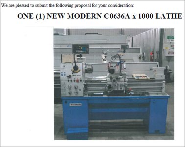

Sorry, I missed your 8K ceiling target. ~Mar-2017 Modern quoted on : C0636A = $7495 and GH 1440W = $12,974, both comparably outfitted with similar stand, DRO & chucks. Prices do fluctuate but unless the currency is working in favor, yes that might eliminate the other machines.

... C036A 14 X 40. This model has had some upgrade in the past year and now comes with a 2" spindle bore like the PM machines as well as D1-5 chuck mounting instead of the 1.5" spindle bore and D1-4
Good point John. This model has changed from the time spec sheet was given to me.
PRO: bigger spindle bore = accommodates larger diameter through stock = more useful
CON: (person dependent) if you happen to have inventory D1-4 3J/4J chucks, collet chuck, faceplate etc. that either has to be converted (if it can) or sell to replicate, then it might figure into the $$ picture. OTOH if the new rotating tooling that comes with lathe meets your needs, not as big a factor.

They quoted me the same price yesterday , same spec d1-4
If the D1-4 vs. 5 is an issue maybe check with them. Could be a boo-boo. I know for the longest time (maybe even still?) the web page listed a different (bigger) model for the GH 1440W then what was on the floor.
John Conroy
member
You're right Peter, their web site is showing old product. Even the manual the sales guy emailed me Is for the old machine. Not sure why they don't update it.
