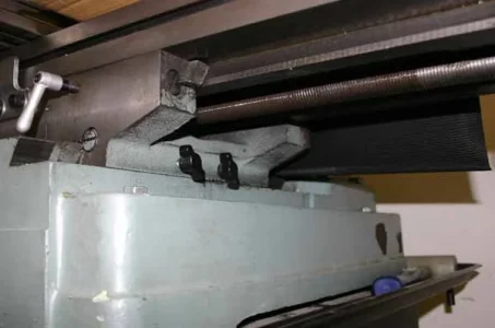

I'm now trying to drill a large hole 1" at very low RPM as a test. The low RPM torque does seem improved, so much so that the table is shifting back and forth over-riding the steppers hold torque. From what what I recall I set the stepper control to only apply partial current when parked to reduce motor heat. that being said I don't think the holding torque will be high enough to hold when I'm doing heavy drilling operations so I need to lock the table.
On the RF-30 mills they have two table locking bolts for the Y-Axis, that are not on the LC30, on my LC30 there is a lock-nutted screw in about the same area, is this for locking? I assumed it was for gib adjustment. Is this a table lock or gig adjuster? Image 1
Now for the X axis, (image 2), I installed a large aluminum L bracket that provides more table surface area for when I machine a large device that I do somewhat regularly and the bracket might be hiding the x- axis lock screws or perhaps not. Any insight would be helpful.

Do you have a LC30 manual? I can't post mine as it's too large to upload. Appears to me the screws with the nut are your locking screws. The manual is not all that obvious though.

Not sure if this is helpful or applicable but my old RF-45 had the classic table locks acting against the gib strip. But it had an adjustable (tapered) gib strip (note adjustment screw on the front). The thumbscrew was maybe M6 thread? Maybe they combined non-tapered gib strip (with a series of adjustment grub screws) in conjunction with table lock. Theoretically it should work as long as you back off the lock completely? I've seen other machines where they skipped the lock altogether which is worse IMO.
These gib locks are kind of cheesy at best anyways. I had the same system on my lathe but got fed up. I made a little beveled 'shoe' & inserted into the hole so it acts face to face against the gib dovetail angle when tightened. The stock configuration only sees the upper edge of the set screw. Worse is torqueing it even hand tight can chowder up the strip & physically displace the table during tightening. Not good if you are trying to hold a setting.

Thanks YYCHM the manual download link works. I actually had a copy, but this copy is better than the one I have. They show the lock screw in the exploded drawing but in the drawing it does not look like it would lock anything. I will lock and report back.
slow-poke
Well I learned a few things today......:)
Those three screws in my original post DO lock the table. Thanks David_R8. I'm still curious are they only for locking or are they also part of the gib adjustment?
My mill/drill has no dedicated lock. Instead, the center Gibb screw has a hand Lever on it to perform that function.
It's very common to have the lock be built into the Gibb adjustment like that.
So to answer your question, they are designed to be Gibb adjustments, but can also be used as a lock by adding a hand Lever to one of them.
