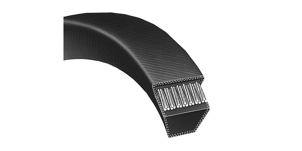

Looking at replacing a 3L belt on a machine with a link belt. I figure I need a 3/8" link belt. Headed to Amazon to find they have a Type A and a Type Z. Not finding a lot of clear information about the differences.
@YotaBota That is a good reference, but I'm still missing some info on the Type Z.
My guess from going over Amazon a couple times more...... 3/8" is a Type Z? and Type A is a 1/2"? I hope that is correct. The one Amazon listing showed a Type Z as 1/2", but you needed to select the one you wanted. This threw me off.
I won't order yet.
Link belt showed up yesterday. It measures 3/8" wide. I ordered the Type Z from Amazon.ca. Approx. $40 for 5 feet.
It seems to sit a little higher out of the pulley compared to the original rubber belt. There is enough clearance around the guard on this machine so I do not think that will be an issue. (I have not installed it yet.)

On the left a A/4L .517" wide and on the right 3L .389" wide.
Both link thickness is about. 100"
