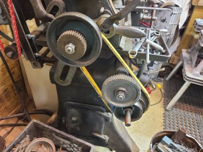

It's alive :D. Made my first test cuts and so far it works great. With one exception the slowest feed on the power feed is .005" per revolution. That's almost twice the feed I have my atlas set at. With the feed engaged i got an absolutely horrendous finish. It looks like a beaver tried to chew it to size. I was using a very sharp to with almost no radius on it. would a large nose radius on the tool help with faster feed? How did they use a lathe 100 years ago with this fast of a feed? I can't imagine people hand cranked it for anything that wasn't a roughing cut. Especially on something longer than a couple inches? I am going to have to solve this problem or I will never be able to move out of my atlas lathe into a big boy lathe. I'm sure I am the problem so any advice would be nice.

Larger radius would help but that also carries the price of more tool pressure. May not be an issue for the machine.
Ya, the lathe can handle a bigger radius on the tool tip just fine.
Don't know what you are cutting, but keep in mind that exotic metals were not as common back then.
The feed rate is keyed to the spindle so the only way to reduce it is with your change gears. Do you have a full set?
