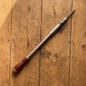

I've had good results using an ancient Yankee screwdriver. It is somewhat less brutal than a hammer powered impact driver. I'm too lazy to take a photo but mine is just like the image below including the flaking red paint on the handle.

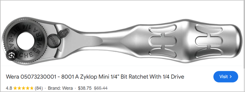

I've had the pleasure of working out semi stripped cap screws. I have used my Wera mini hex ratchet with success. The nice thing is you can push down on the head to keep the bit engaged with your thumb on one hand & of course the handle length offers smooth torque as leverage on the other. The other thing is I have ground/modified a (now disposable) hex bit to better engage a mangled hex or slot or whatever. The trick is to make it as tight fitting as possible. In some cases I've Dremelled a slot across but that's not always possible like flush fastener. I've snapped the heads off some bolts up to #8 size so I know the ratchet mechanism is pretty solid.
