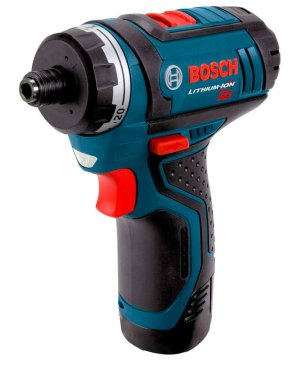

For your specific application I would look at an adjustable torque impact driver like the Bosch PS21-2A:
PS21-2A on Amazon
PS21-2A Kit Page on Bosch Website
I have an older, non-adjustable version, but have added this one to my wishlist since I already have the batteries & charger.

While I don't use them on a daily basis, I've had my Bosch PS40-2 10.8V Impactor 1/4" Hex Driver (New?, 15+ years), PS31 12V 3/8" Drill (Renewed, 10 years), PS11 12V 3/8" Right-Angle Drill (New, 5 years) & PS50 12V Oscillating Multi-Tool (New, 15 years) with no issues. I look forward to my Renewed PS21 performing similarly.

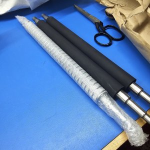

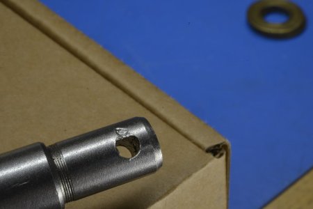

Agreed they were a good make with a good reputation ...... then KKR bought in them 2017. You know what happens next .... hold price, surf on the brand and cut costs to the core. For these three rollers I spent about $200 + 50 to get them thinking I was getting good German quality. Instead made in China near junk. Flaking chrome, centres are way off from the OD (I needed to turn the bearing mounts down) and a hole for the pin is a mess. I fixed it, but still, that for German prices? Also sent a die grinder back two years ago because of the vibration.
Granted, its just a couple of parts .... but those are low end made in China parts at German prices and that's what firms like KKR are reputed to do. Just giving the rationale behind my negative statement about Metabo.
