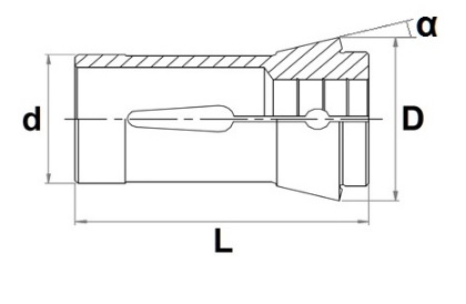

Okay so these are definitely not Brown and Sharpe #21 collets. I requested the dimension of the collets and got these dimensions back from the owner.
Collet dimensions as follows:
d= 1.887
L= 3.683
D= 2.392
d internal= 1.660.
In my book that makes these collets DIN 6343-48, or as Hardinge calls them B42 or TF48 index round collets. I'm not sure what their dimensional tolerances are but I'm betting the owner used calipers and not micrometers to measure these dimensions so that would explain the slight dimensional differences. The dimensions are very close to the standard, and the dimensions are not nearly as close to the dimensions of any of the other 30 plus collet types I checked in my charts.
d (A): 48.0mm OR 1.889"
L (B): 94.0mm OR 3.700"
D (C): 60.0mm OR 2.362"
α = 15° angle (hardinge says 14.5)
One of my charts lists the internal diameter as having a M43 x 1 thread (1.6929")... the measurement I was given is 1.660
So now unless someone wants to suggest something else I think we know what we have.
