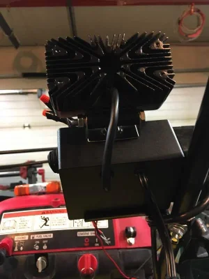

I'm a snowblower geek. Started out in the 1970s when I bought an old Craftsman 3 stage "Driftbreaker" to do our local hockey rink in Glendale. (It was missing the muffler, which was the best part for a 12 year old). I've had Toro's, MTDs, Ariens, but these days I am a die-hard Honda fan (of their lawn mowers and generators as well.) I just love their small engine designs (now nicely copied by Princess Auto).

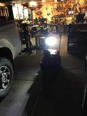

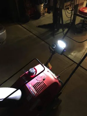

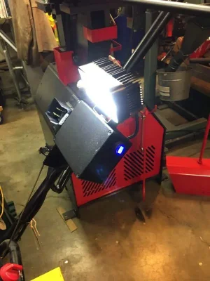

Anyways, not much metalwork in this mod: a LED light on a single stage HS520. In this case I just fab'd a new mounting plate by punching some holes into 0.125 A36 and moving the starter to the side of the new battery box. The box is a simple aluminum project box from B&E in Calgary. Added a Battery Tender Junior spare tender pigtail, fuses for the BTJ output and the LED itself, plus a weatherproof switch. The newer model (HS720) doesn't lend itself to this mod so I need to devise a template that wraps around the handlebar and allows for accurate on-center drilling. I have 15 of these to do for people I know.
Taking off the handlebars is too much hassle. The handle bars are a metric tubing size. I've seen cool templates/jigs that are bored out to the right size, cut in two and have a six inch drill guide to ensure accuracy. I may try this approach. Also looking at a clamp type design that can support the battery and electrics as well as LED for those who don't want to mod their precious Hondas. Some people use tilt switches on the single stage machines or elaborate auger engagement switches with the light. Personally, I like the simple battery tender approach because the purpose of a light is more about being seen than be able to see. So I have mine on at all times.
I do up to 26 properties and learned the value of lights and reflective PPE the hard way.

What's the amp-hour capacity of the battery & how long to charge? I've got a motorbike type gel cell that looks about same size.
It's 1.3 Ah. Gives me 3+ hours @600 lumens, which is more than enough to get me through early AM snowblowing. I get another 3 hours with reduced brightness. It's lead-acid standard battery from Active Electronics. Takes about 90 mins to fully recharge using a cheap Battery Tender Junior.
