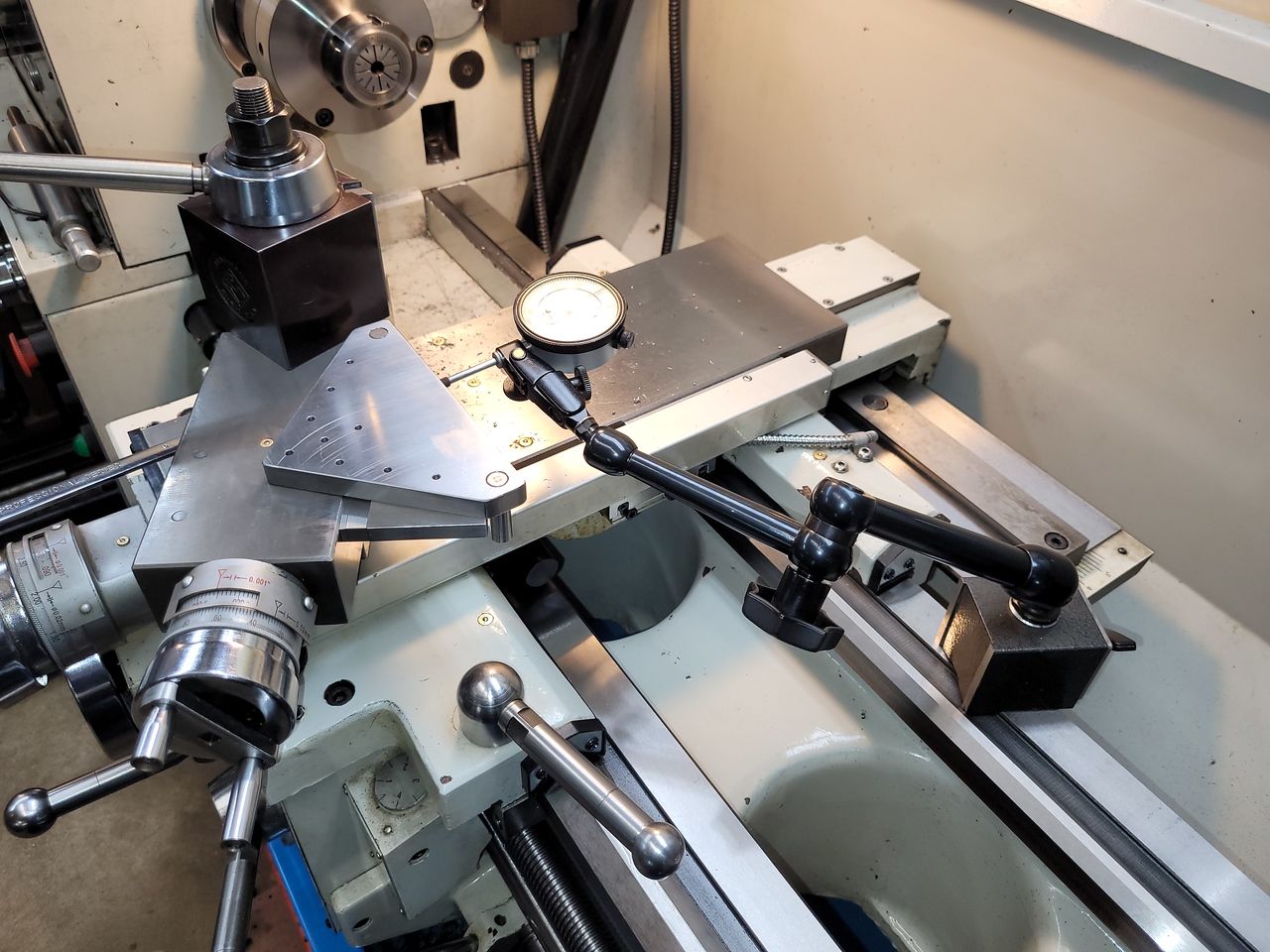

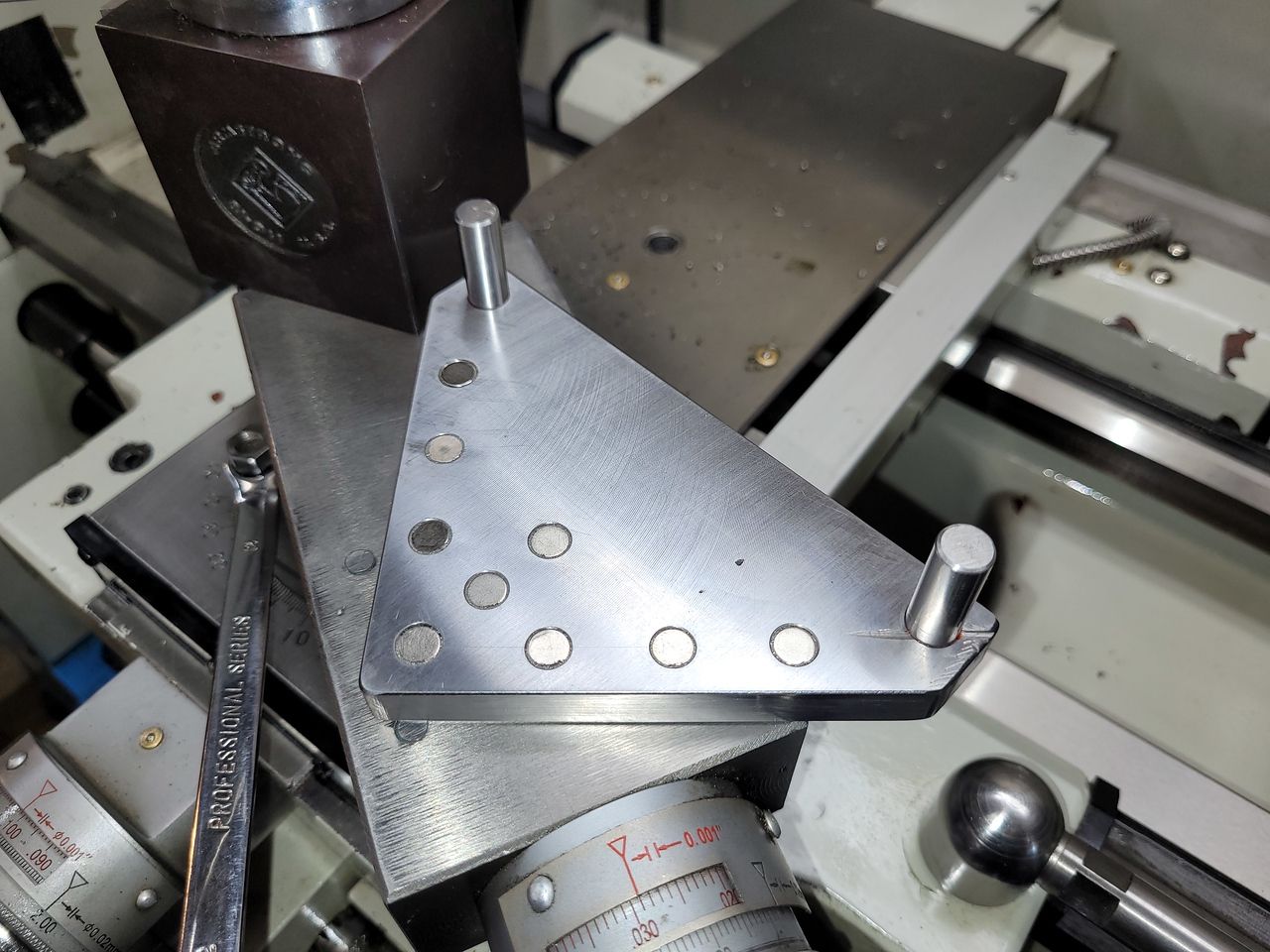

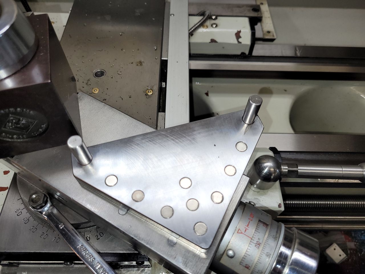

Here's my version, made up of a chunk of 1/2" thick hot rolled plate, two 1.5" long 10mm dowel pins, and nine 8mm X 3mm magnets. The pins on mine are spaced on 5" centers and I have printed a "Table of Constants for a 5" Sine Bar" from the Hermann Schmidt Company (easily found with a google search and a very nice pdf chart) for quick reference.
Try to ignore the gouge made during a bandsaw mishap, the operator has been chastised repeatedly!

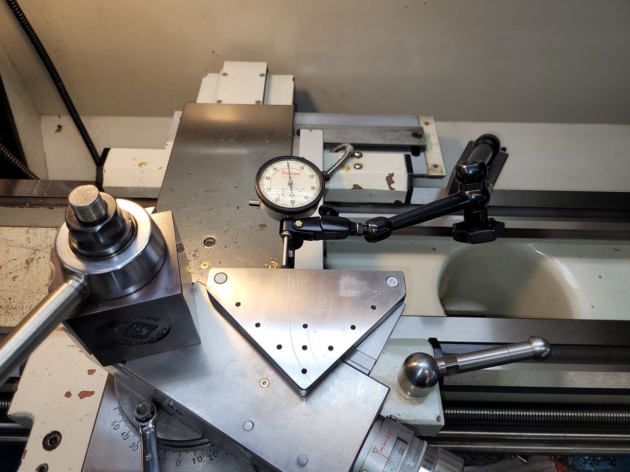

Here you can see it set to give a compound angle of 29 degrees, 30 minutes. The table of constants says for that angle and a 5" sine bar, the constant is 2.462" so I have stacked under one of the pins a 2" plus a .350" plus a .112" gage block. The magnets are strong enough to hold everything in place while I sweep across the face with an indicator and adjust the compound angle until the indicator needle is stationary.
I have a cheap 83 piece gage block set and have measured every piece and they are all accurate to within .0002" so plenty good enough for me.

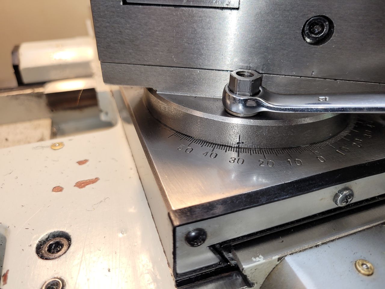

The engraved numbers on the compound of my lathe are off by about 1 degree and a few years ago when I got the lathe I put 2 small center punch marks on the compound and the space between them is where the line should be. I sure wish I hadn't done that now.
