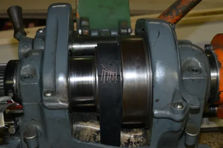

I have a SB Heavy 10L with the single gearbox lever. The bedways are worn but even so I was able to turn a custom ACME lead screw for my Gingery Lathe with it. Just tweak the cross slide in/out as the carriage traversed the worn sections.
I added a face plate and a MT3 adaptor to it and it already has a taper attachment and full set of 5C collets. And of course my Electronic Lead screw now allows me to do metric threading and all the turning and boring to a given set point.
Back in 2006 I paid $2500 for it which was probably way too much. I also added adjustable rubber bottomed feet to it and changed from the leather belt to a stitched multi ribbed rubber belt.
I also swapped out the 1HP single phase for a 3 phase with VFD. At the moment I wouldn't upgrade to anything else.
