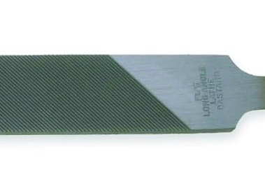

After seeing your photo, I took a second look at the photo of the 10" Long Angle file:

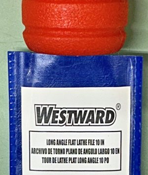

Then checked my Warrior 10" Lathe File (Grainger/Zoro brand):
Angle is significantly shallower (30°) than the Nicholson, which looks to be ~45°.

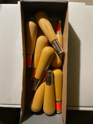

I've got a few golf ball handles. They do work, I like them on smaller files, not so much on bigger ones. They don't fit in drawers, where I store most of my files. I turned some nice wood handles years ago with copper ferrules. Always wanted to make a bunch more someday, but just never got around to it. The last couple file handles i made I simply drilled chunks of hardwood pallet, pounded them on and then shaped them on the disc sander with flats, not round. Some with 5, some 6, some 8. They were actually very comfortable to use, and very quick to make.
I'm always torn between taking the time to make nice things, and just making things quick to get it done and over with. The pallet wood was a done and over with decision, but they turned out pretty nice and functional it makes me just want to do that from now on....
I actually use a lot of files without handles....gasp....ya I know, judge me....o_O. Not on a lathe though, never on a lathe. But for hand work, sure. I preferred them mostly handless because they fit in my toolbox drawers better, and using them flat to deburr plates was handy and something I did a lot. But my most frequent users all had handles. If I ever get a nice bench space to work at, with room for a big file rack, I will put handles on the entire drawer full.
I think that's the most words I ever wrote about file handles lol.
I have mentioned it before... I find drilling a golf ball and hammering it on makes a file handle that fits my hand just right. Everybody has, or has a buddy with golf balls to spare. They stay on securely and do the job.
I would rather a fine cut than course. You're not likely to being rough filing anything on a lathe, that's what cutting tools are for. More likely to be filing in a fit/finish, or for chamfers where a fine cut would be better suited. If I ever need a rough file on a lathe, it doesn't need to be a long angle lathe file. My take on it anyway..

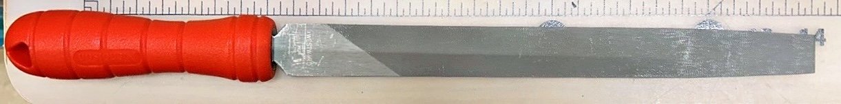

I just received my new 12" Westward lathe file so now I can toss the old one I have used for 20 years. Made in India. I got a Nicholson in November and I felt it was too short for me. I prefer my hands to be well away from the chuck.

Longer tooth angle. Supposed to cause more of a shearing action. I had one at one point a long time ago, no idea where it went. My favourite lathe file was always a std 6" single cut bastard. I don't file surfaces in to fit or finish on a lathe very often, mostly just to edge break. Even if you do, you can skew the file for more shear angle anyway, but you can't do that next to a shoulder. Maybe I should buy another lathe file again just to buy some tools. That's what we do right? :D
It's been a long time since I've used one, but I think you're right, they do have a safe edge too Tom.

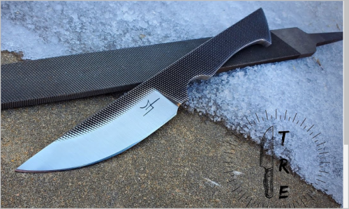

If the metal is decent, don't toss it. Make a 'self defense screwdriver'. As long as its labelled in both official languages, good to go. Current hardware store files are made from 50.2% soupcanium.
Very nice. It's hard to get a carbon steel blade now, they want the shiny stainless steel that won't hold an edge. I made a knife once from a planer blade...big disappointment, as soon as it hit bone the edge would chip.
