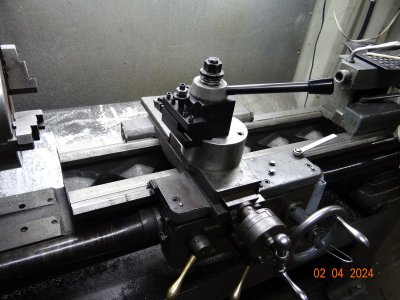

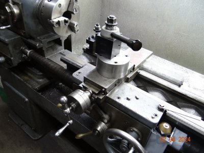

Well now, it's a bit over a month later and the 20mm taps have arrived, and I got the holes for the post threaded and done. I had a grim time trying to find a drill that would give me somewhat the right sized hole for threading. I needed .702 and settled for using an endmill at .712. I did not want to set up and bore two 1 inch deep holes with a boring head.

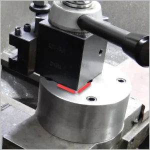

Looks good. Are you dowel pinning your tool post to the block or using any kind of external angle bracket? I noticed a lot of guys went that way (mimicking Rob Renzetti & Stefan.G) who pointed outthat is another potential degree of slip. My own thought was to use 2 Mitee Bite eccentric fixture clamps on either side of the corner.

No, I'm not planning to pin it. There is a hole for a pin on the underside of the block, and when I bought it a pin was included but that is long gone. If I see any need for doing so I will pin it. I would like the freedom to move around on the top of that pedestal and I have a centerline hole as well as the offset hole, and an external bracket puts paid to any of that fancy footwork. You may have noticed that there is a thrust bearing that was wandering around and I put it under the locking nut, and that truly was an amazing difference in clamping power. I will be surprised if it moves out of line with this, but now that I got power to cut more than 50 thou we'll see.
I'll machine a plastic skirt to keep the crud out of the thrust bearing sometime.
