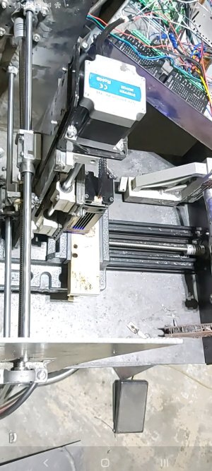

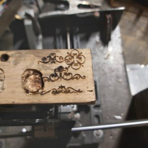

I decided to replace the spindle on my homemade milling machine with a 7.5w laser module to create a laser engraver. the Laser isn't as powerful as I thought it would be, I expected it to able to engrave metal but the claim of it being a 30w laser pointed to the electrical power where the optical power is only 7.5w. It can still engrave wood, plastic, coated metals, etc; but it can only cut certain materials yp to 4mm thick.

There are some more high quality modules manufactured in America, like endurance lasers that are up to 8 - 10w; but they cost a great deal more. Diode lasers are better for engraving metals, because the wavelength also makes a big difference. CO2 lasers don't work well on metal because of the wavelength, thats why fiber lasers are used more often for cutting metal.
What happens if you just go really slow? Can you then mark metals? What happens if you use an acid etch pen and evenly cover the surface then laser it?
Bare metal cant be engraved even if you go very slow. Unless it is treated or coated with engraving compound or paper, then a high percentage of the light is reflected of the surface of most metals before it delivers enough heat to engrave the metal. copper and aluminum are especially difficult to engrave, not just because of their high reflectivity, but also their high heat conductance. high powered fiber lasers work well for cutting and engraving metal, because they deliver enough heat upon contact. Other materials that aren't as reflective or conductive but are still hard, can be engraved by traveling slow, and running multiple passes. I might try engraving a tile, as that was on the list of things they claimed this module could engrave.
