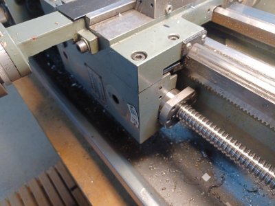

I replaced my lead screw with a ball screw last year for better accuracy. Simple enough which only minor machining on the carriage apron although even that is avoidable if you take the risk of flipping the ball nut.
