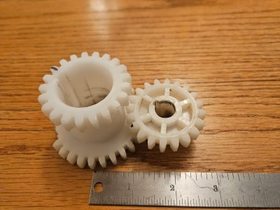

Please help me identify these gears (Module or Diametral Pitch) and where can I get Metal replacements.

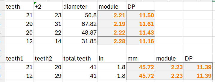

Large Gear set = 21 teeth, 29 teeth (50.8, 67.82 mm Dia. Approx.)
Small Gear set = 20 teeth, 12 teeth (31.85, 48.87 mm Dia. Approx.)
