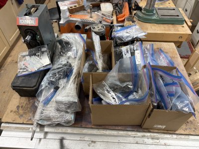

Well my new project from @PatrickT is in the shop. I cleared a location for it on a heavy wooden bench.
All the parts are bagged up by area, so it should be reasonably easy to re assemble from the ground up.

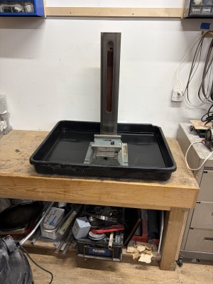

I have a deep plastic tray (see picture) to put under it, for holding and catching coolant. I think it may be to deep though, about 2.5-3”. Can I just set it on the bench? Will that be stable enough? If I drill through the tray and bench to bolt it down, how do I stop the leaking and still keep it solid. A rubber gasket, would remove some stability would it it?
Get ready. I will be asking lots of questions.
The factory stand puts the mill at 32" above the floor. I find that too low, so I ended up sitting on a 1960's drafting stool while using the machine. It looks as if yours is even lower, your back will not be pleased.
The 2.5" tray will be fine, except at the front where the Y axis wheel is. Your left and right Y axis hand wheels will likely interfere as well, even it is just your hand on the handle. And, the cabinet to left of mill will interfere with rh end travel limits. Put a ring of sealant down as suggested before bolting it to the work bench.

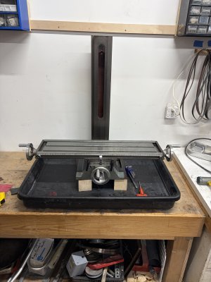

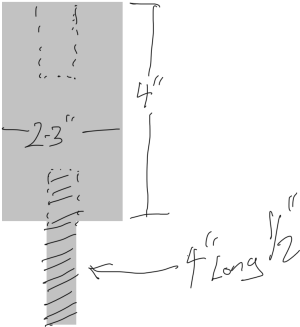

Instead of the wooden blocks (temporary). I plan to make 4 standoffs, using 2” diameter steel rod. Make them 4” long, and tap both ends 3/4’to1” deep to take 1/2” threaded rod. The bottom will get a long 4-5 inch piece, to get through the table top, with a bit of silicone sealant to keep it from leaking. The top wil get a 2” piece to bolt the mill to.
Any thoughts?
Sounds sturdy enough, can always change/improve it later if needed. Try to get them all the same length of course to avoid twisting the base casting. When I got mine, I ended up adding a 1/2" MDF layer between the metal pan and the cabinet for noise/vibration dampening. I think your setup will avoid that.

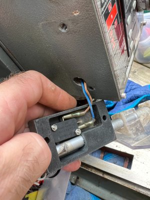

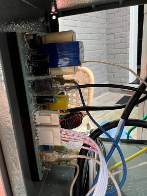

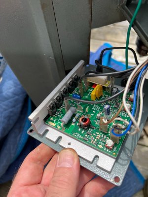

Found these in the archive from disassembly, hope they help. Let me know when that motor cover arrives safely.

Just my 2 cents worth... dont think I would have used stand-off's, I would have used 2 chanel iron chunks with 2" webb just long enough to fit inside your tub and bolted them to the mill base only. The width of them would have been sufficient enough to stabilize the weight of your machine .
Well, this was how I spent my Friday
Bought 2” hot rolled steel rod.
Cut, faced and trimmed to length.
Drilled and tapped for 1/2” theaded rod on one end.
Then 3/8” bolt hole on the other.
It was pretty heavy shifting, but I got holes in the bench drilled and the mounted on top.
Just at the end of the day, I got the head mounted. Was definitely some head scratching to figure out the best order to assemble, by myself.
Today I will finish the Z handle and sattache the motor.
That could have been an option. Probably would have cost quite a bit more, and I think I prefer the mill being bolted to the bench.

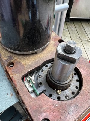

Got it all assembled today, and by a small miracle, it works.
Had to use a drill press vice, and a 14mm end mill in a drill chuck. Made a couple of passes on a piece of junk box steel. Worked pretty good, but I have a lot to learn.Right now it is set up by eye. My next step will be to level and tram the head. I am 90% positive I will never use it with the head tilted.
