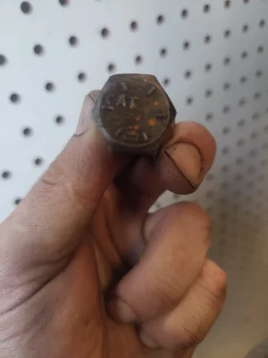

Oh look...apprentice marks...

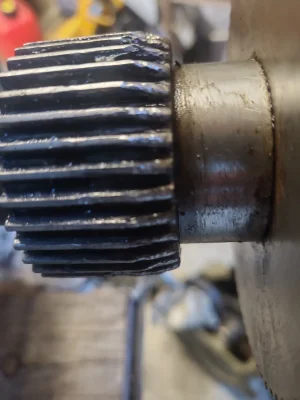

That gear came out of the speed change gizmo...the pin in the back for the gear pack engagement...not even locked in to place...
This tumbler looks like it was half engaged for a while
There's 2 of them on this unit...both in similar condition
Equipment mechanic tell-tale sign...

But upon light up, the gear train was making some pretty hellacious noise...
So I started looking deeper...
Lots of loose fasteners...some chipped teeth...
Not surprised...it IS 100 afterall...

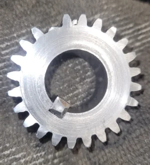

No such luck...didn't look at the gears first...tapped the old gear onto the shaft...nope...not engaging...hhmm...that's weird...
Maybe I should just whack it with a hammer...No...let's try looking first before we resort to BIM's (Brutal Installation Method)
Oh look...it is in fact NOT same for same...
For context, I didn't look at the new gear until the no engagement thing...I figured the old one fit the shaft...it should be ok right...
Not a huge dilemma...I just have to turn the ID out to match and I'm good.
