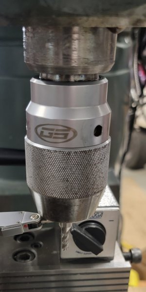

The GS runout in the spindle is just under a thou which could be chuck, end mill I used as a gauge, or spindle. Who knows. Someday I'll find out what contributes what. In the meantime I'm not fussed about it.

My GS is just under a thou using the shaft of a 3/8 endmill that I got from some mysterious place far far away..... (Insert big grin here).
Foolishly, I expected better but the more I think about it, I really should celebrate. Especially since that's total runout including the spindle, the R8 Taper, the chuck, and the endmill. It's also just one reading on one diameter part which might even have runout that might offset other runout elsewhere.
Anyway, thanks for the numbers which give me reason for pause.
