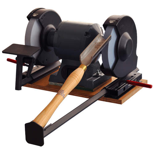

The grinding rest that comes with most grinders is...not optimal! I bought a Wolverine grinding set (made by Oneway Manufacturing in Canada) many years ago:
Ignore the right side that is set up for sharpening woodturning gouges. The platform on the left is the one I have used for grinding HSS lathe tools, etc. The table is 1/4" thick steel. The rest adjusts to any angle and can move in and out from the wheel easily. I was thinking about milling a recess in the table so it would wrap around the grinding wheel by 1/4 or 3/8 of an inch. However, I got a 1X40 belt sander that I've been using lately.
The standard Wolverine kit ($90) includes 2 bases, 1 V arm and 1 rest. I know they sell the pieces separately, as well. They also have other stuff like kits for balancing grinding wheels, etc.
