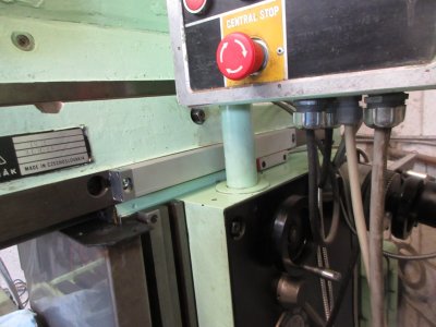

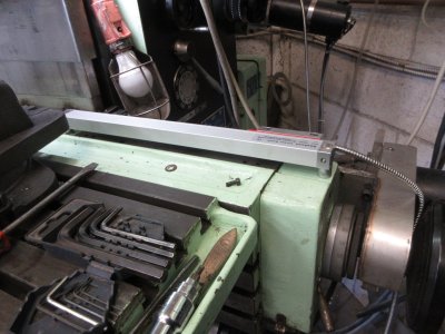

I started on the Y axis as it had a TEE slot for me to mount the scale. The DRO uses magnetic slides of 5um resolution. Installation was a bit trying as the tramming of the slide was to be within .006" before mounting the reader.
Tapping the mounting holes for the reader became a bit of a challenge, but cast iron is soft so I didn't break a tap.

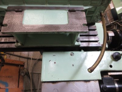

The Y axis was the easy axis. But like I said I was in healing mode and my body could only tolerate about 2 hours in the shop each day. In my mind I thought how long can this take, well just like Elon Musk I over state and under deliver. On to the X axis. I contemplated installing this under the table and looked on the internet as some newer TOS machines came with a DRO and the Deckel FP2 & 3 had the X slide under the table, it however presented a few problems.
As you can see, the TOS just like the Deckel it is possible to remove the work table. The face now allows larger parts to be mounted and machined and the dividing head to be direct mounted to the T slot face of the machine. Many years ago I would do this by hand, now not a chance. I have a swing davit and a coffin hoist to do the lift, but swinging the dividing head or table into the face and I know that the slide will get hit and damaged. I decided to install the X axis slide where the X axis imperial scale was installed and removed the scale and pointer for the installation. Also the slide would not be mounted to the centre of the axis but to the right side of it. Should work? As long as I now position the reader to the right side as well.

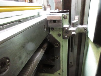

This is the X slide mounted. I had to install spacers so that the reader would clear the machine when the X axis traveled.

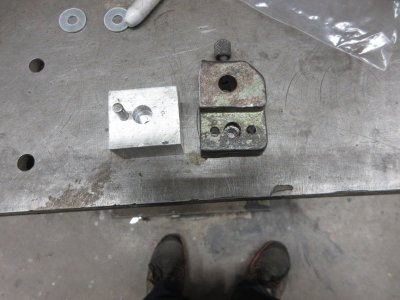

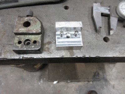

It looks like it will work and it is out of the way. On to mounting the reader. For this I removed the x axis scale pointer and copied it from a block of aluminum.

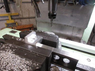

I can tell that this machine was hand assembled as none of the holes lined up nor were equally spaced. To make the part I needed the mill and of course threw chips everywhere I was working.
This is seat of the pants engineering. Make a little, measure a little then adjust and machine as required. I am moving forward.
The DRO kit came with brackets, that well... just were of little use. However I managed to cut the reader bracket and attach it to my adapter to mount the reader head for the X axis.

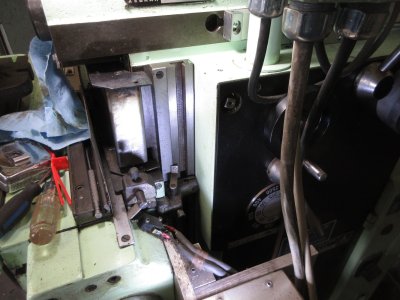

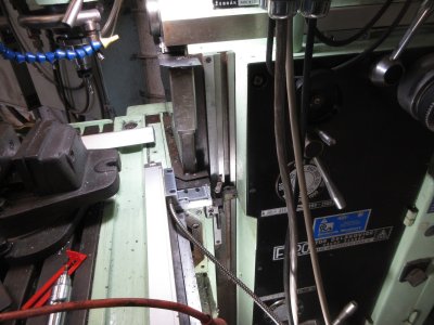

On to the Z axis. As you can see the Z axis is the longest at 13 3/4". Here is a look at the slide on the bench. Although the travel is 13 3/4" the solid sliding way covers that I made reduce that travel by 2" on each side. The machine came with bellows way covers that were in really bad shape so I made up the sliding stainless steel way covers thinking that should the need arise I would remove the cover I needed to do a particular job. It has been 12 years and I have never had to remove the top or bottom way cover to do machine a job.
Installation again was similar to the Y axis where I removed the imperial scale and used the Tee slot to fasten the slide. The pointer was removed and adapters were made to attach the Z axis DRO reader.
