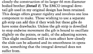

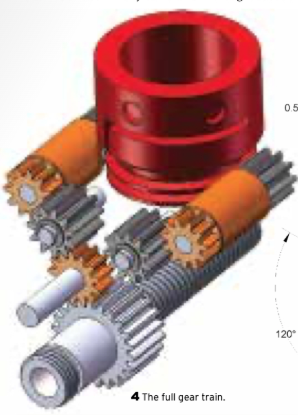

One of the main differences is the diameter, 50mm instead of 66mm. And:
There are other differences as well but the notes are spread around a bit throughout the article. Gears are cut using a fly cutter. (I didn't look at the 2016 article)
