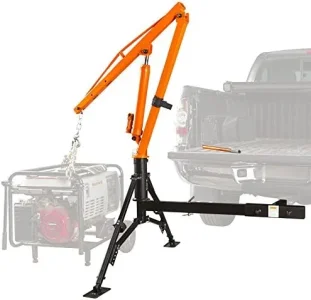

At home I have machines and hoists that can normally lift things, but this weekend I did a transmission R&R job on an F150 that was on the hoist and thought it would be nice to have a jib crane, or a small hand forklift to get the transmission off the 3' high transmission jack and onto the ground, and the new transmission onto the jack. So another new idea was born. I ended up using the trucks receiver hitch and my small cable come along. It worked, but seemed pretty primitive. I had an engine hoist a few feet away, but its a pain to setup too for a 30 second lift.

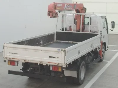

For my next truck I want to import one of these bad boys 2000kg load cap and a small crane in foot print of a f150 solve all my portable lifting needs :)
I build out a few trucks in my shop. Bare frame to fully done work truck. Shortening, lengthening, 2wd to 4wd, dump beds, flat decks, etc. One of the next ones is a very low profile 4 segment boom, 800 lbs capacity, manual extension, that can reach 22', with minimal weight, minimal footprint, once every 1000km usage. He cant buy it, so we will build it. So that is a consideration. I have my equipment trailer that we may also add a prototype boom to for testing.
