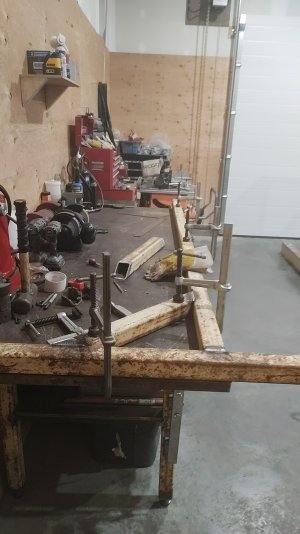

Impromptu gantry crane build

One day I want to build a super lightweight, knockdown , Portable gantry. Truss type design, for light weight and strength, knockdown for portability. Something i can toss in the truck and go.

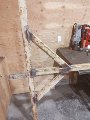

I have been invited to show my " articulated jib crane". My basement was 10' high before the hung ceiling and lights were installed, so I have 8'3" under the lights. The column and "elbow" have PA flange bearings for 1 3/8" dia. bar. The primary arm is 5" square tubing with fitted and welded plates inside to resist parallelogram distortion when the secondary arm is off an angle and torquing the tube. The bearing on the bottom of the column sits on a large steel plate with concrete anchors and is grouted in place with expanding grout. It sits on the floor above the footing that is in place for the telepost supporting the main floor beam. The top bearing is mounted to a U bracket that fits the wooden beam and is secured with a couple bolts through the neutral axis of the beam.
The PA "electric cable hoist" was much too fast for my liking so I added a block above the hook to reduce the speed to 1/4. The speed was still an issue when trying to gently place the mill vice or fit chucks to my L0 lathe spindle, so I added a PA linear actuator to the cable anchor point so the the hook moves at 1/4 the speed of the linear actuator. Very nice. Shown are the lifting fixtures for the mill vise and the lathe chucks. They are configured to lift at the balance point of the vise and chucks. The chucks can also rotate on the lifting jig to align with the spindle key. This is not a heavy duty lifter, just an aid to keep an old man from killing himself. Glad to answer questions.
