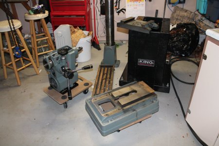

Now you should build a sturdy BASE to bring that table and spindle up to working height.
I see the power feed is there for the X Axis.
It will be good to see it in operating condition.

It was sitting on a metal base that wouldn't fit in the truck. My car is dead and don't think I can head back in time before it gets tossed :(

That does appear to be the same design as my RF-30. Which means the machine is closer to 600 pounds than 500. I found one of the bolts connecting the round column to the top of the rectangular intermediate casting was completely stripped. Another stripped when I was reassembling the machine. Eventually, I drilled out a couple of the threaded holes and used nuts and bolts to fasten the connection. The gory details are in the thread linked to earlier. Something to keep an eye on when working on the machine.
Appears your machine was hard-wired? Is it 3-phase?
