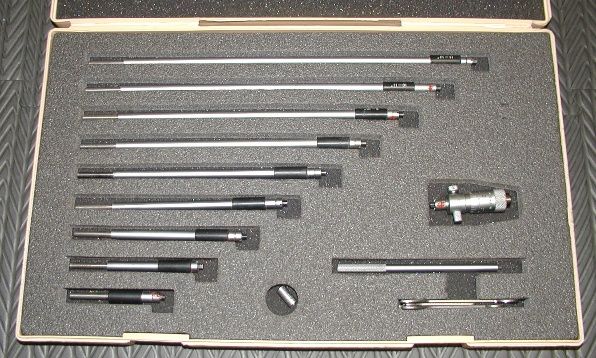

And what did I spy with my little eye but a 12" Mitutoyo inside micrometer set (141-133) that looks like this:
I've been wanting something a little more than my digital calipers so this should do the trick even if it is analog. It covers up to 12" dia. and by comparison to my 2" mic and calipers appears to be dead on in cal or as much as can be said in comparison to instruments not in cal!

When I worked at a place that was serious about calibration the procedure was to use it an inside mic like a telescoping gauge. Set the inside mic to the size of the bore but instead of reading directly off of it, one would use a calibrated outside mic to take the measurement off the inside mic. Reason being an outside mic is much easier to calibrate properly off a standard or with gage blocks.
12” is a nice size I found the larger one in the pawnshop they were asking too much for a couple years so I made a offer telling them how long it’s been here and it would make room for other things that would sell so I got it for $150.
Funny you would mention that, I was thinking that if I really needed to measure something with an outside caliper (not a diameter) I would fixture something on the ends of the part like angle plates and used the inside mic to take the measurement. That, since I don't have anything other than a ruler to measure more than I can with a 6" caliper except my mill DRO. The extender rods are all set with Torque Seal so I would go on the assumption that they are in cal from the last cal cycle......from, like years ago. LOL!

Oh, As I was surfing around today I saw a Mit jig for doing cal on the rods!

When I was working in the press room at the Calgary Herald to tram all the rollers they used 3/8” pipe and fittings holding an inside mike on the one end and a 3 way fitting for centering the tool on the other.
