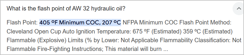

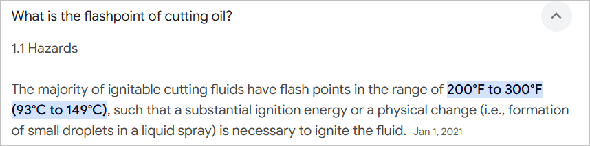

I was wondering the same thing. So many products out there so hard to say but hydraulic doesn't look significantly different than a lot of motor oils? Not that motor oils are used for cutting. But I started hopping around some of the cutting oils we use & some appear to have a similar or lower flash point?
cutting oils
flash point regular oils
