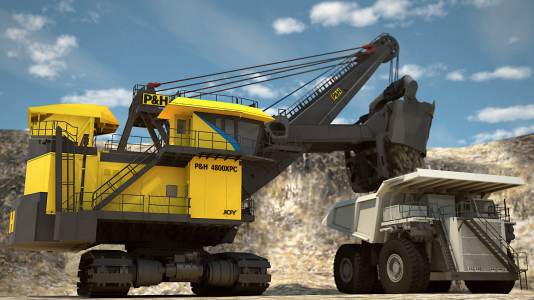

I think you mean the shovels? machines that make 300 ton 60 foot high haul trucks look small. Standing next to one my head is at the middle or just below the axle on one of those tires. If you have any pictures...
That’s exactly what we work on, in fact currently we’re rebuilding all if the load roller bores in the track frames on a shovel just like that. Pictures are usually a no-no with our clients, so not something I can share often.
The trick with photos of things like that is having any vague sense of scale.
I remember looking at a listing for a lathe a few years ago, not really knowing what I was looking at, and then realizing there were stairs up to the platform you stand on that rides along with the carriage...
