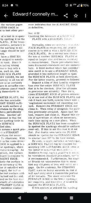

I’ll probably noodle around a bit to see if I can figure out how the “old guys” calibrated them before the fancy electronic gear was invented.
In Edward Connelly's book he talks about checking a surface plate with a camelback. If you happen to have one you could possibly check your plate using his method.
I've seen mention on PM there was ways of checking plates with master levels and piano wire but couldn't find any detailed methods of doing so.
