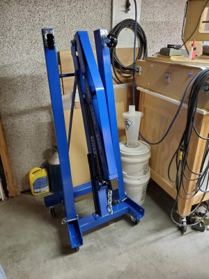

Well after spending another 2 hours mowing the rest of the lawn I am looking forward to using my new Princess Auto 2T engine hoist to pull the motor off this and replace the CAM shaft on the B&S engine. The tractor was a gift from a friend who bought a new JD since the quote for a commercial repair on a 2011 tractor was over $1000. He's just had the blades sharpened and the belt replaced. So he bought his new toy and he and his son pushed it from their house to mine..
It's sat under a tarp since last summer since the CAM from B&S was on indefinite back order. Now they are available again and I'm ready to fix the engine. It's an easy repair as long as the broken parts don't cause issues. The far east Amazon CAM kits apparent have a life of a few hours before they die. Not worth the risk.
Yahoo. Now just to clean up the driveway area (coniferous needles, cones, grass and dirt.) and then I can wheel the garden tractor out, pick up the front end and remove the engine.
I even swept that little bit of floor there before I rolled it into place. Really do agree with one of the remarks on the Princess Auto site for this unit though. The two front 3" casters should really also be the type that can turn. Easier to move around when it's folded up. Only one crappy nut that was malformed. Luckily I had one of those metric nuts.
