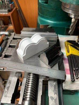

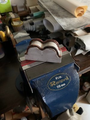

Hi All,

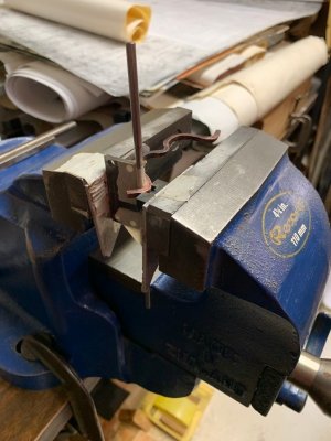

More creative bending to finish fit the front rib. The very tight end bends were the worst. One more to go.
One thing I didn't mention was, when bending the straight blank piece, I started the forming in the centre and slowly worked out to each end. And sometimes I had to bend the copper into a shape I didn't want just to be able to get access to bend anything at all.
When finished, I will glue the end ribs onto the wood body.

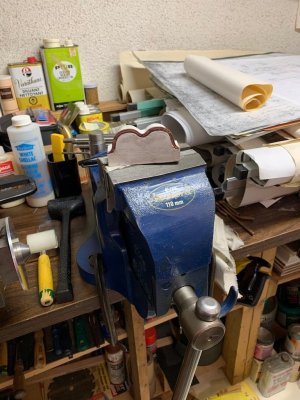

Hi All,
The most difficult way as usual. I don't want to do this ever again.

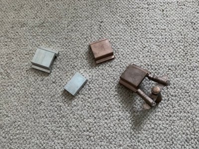

Hi All,
The finished brake cylinder pattern(s) which will be going to the foundry. Will see what comes back. It took far to much time and effort but now that it is done.

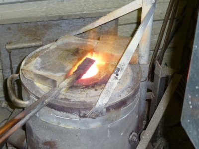

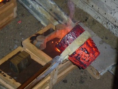

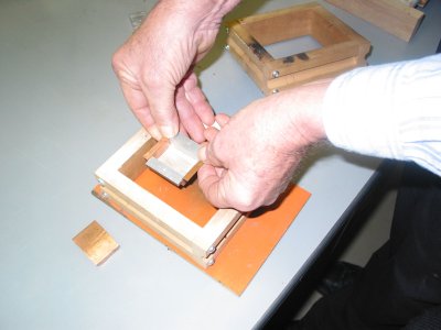

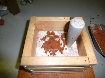

Some photos which I took when I was there last.
