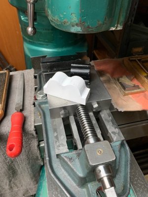

Hi All,
Pushing on to where I am now.
The two cylinder pieces were first glued to the base block cutouts with some white glue letting the glue dry for about 24 hours and then the contour fillets were added in small thin incremental layers (approx. 4 in total). I let the filler dry for at least 24 hours before adding the next layer. I used standard plastic wood because it was cheap but in retrospect I maybe should have used something better like Bondo.
The next mistake made was to belt sand in the pattern draft (3 degree taper) on each long side. Don't do this as then it becomes very difficult to hold the partially made pattern straight in the vise for all of the contouring operations. Because of this, I had to keep reversing the tilted pattern in the vise after each pass of the ball end mill to end up with a straight cut.
Contouring the pattern plastic wood fillets and contours and blending them in to produce a seamless curve was undertaken using various diameter ball end mills and then finishing the continuous curves by very careful riffler and regular filing. It was quite concentrated and tense work as I had never attempted to do it this way before. The plastic wood, even in its hardened state, is quite weak and turns into a fine soft powder under end milling. I ran the mill at its highest speed and took only very light cuts (0.003" DOC) while feeding the end mill VERY slowly across the work taking particular care when entering or exiting the workpiece. Even so, there was some minor fracturing of the plastic wood filler at the sharp side edges which were then patched up and left to harden. This is where I think something like Bondo would have worked better. For the two cylinder side fillets the pattern piece was tilted 3 degrees (and sometimes more) in the vise using the reversal method to achieve a straight across cut to remove almost all of the excess fillet material and then blend it all in with careful hand filing.
Still have the all sides final draft to do.
As welI, I will try to harden the plastic wood fillets and contours (before the final shellac coating is applied and painting) to prevent damage in these areas when sand is rammed around the pattern as the plastic wood filler remains quite soft and weak.
Live and learn.
to be continued.

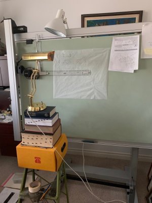

Hi All,
Starting to draw the double brake cylinder machining drawing. I am a dinosaur as I do drafting the old fashioned way on a board as I was never able to master CAD.
Due to my wonky eyes, I need the Rube Goldberg lighting setup shown to avoid casting shadows but I do need proper overhead drafting illumination custom suited to the drawing board I am using. I also use the OptiVisor when drafting small mechanical details like this.
Boy, am I slow, I could never work in industry where everything needs to be produced yesterday. But on the other hand, my drawings are correct and can be machined exactly the way they are drawn unlike many other drawings I have encountered by persons who should know better (details referred to not shown or are incorrect, half drawn mechanisms that cannot possibly function that way, threads shown threaded right up to a square shoulder or right to the bottom of a blind hole, it goes on and on.

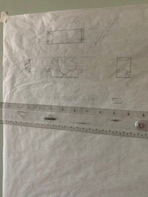

Hi All,
I finally finished the double brake cylinder drawing. What a relief!
I still can do drawings like this (despite my printing scratch) but it really tires me both physically and mentally now.
The 2D sketch and the Drawing dimensioning in Autocad Fusion is a great investment of time as the payback is greatly improved productivity. It's free for hobbyists with some minor limitations.

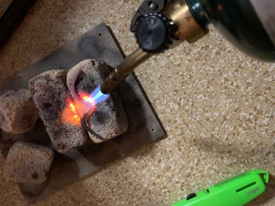

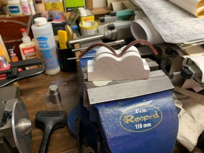

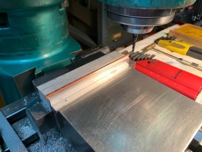

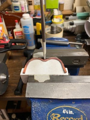

Hi All,
What is this crazy doing now.
Milling a 1/8" wide shallow slot approximately 0.050" deep in a 4.5" long piece of scrap aluminum as seen in photo 50. The slot was carefully made to be a good tap fit for the 1/8" square copper work piece as seen in photo 51. The copper has been heated and annealed all over several times so that it is dead soft and malleable. It came as a bent up mess so the first operation was to straighten it out by heating it red hot and hammering it (with a non metallic hammer) straight in progressive steps against a flat surface.
I went and paid a crazy price for this one foot long piece of square copper as it is not available anywhere in Canada (as far as I know) and only on special order from a jewellery supply in the USA. The shallow slot can be used to further straighten out the copper although this is not its primary purpose.
I have no idea if what I am about to try will work as I have never done anything like this before so in my head I have plan B if everything goes south.
to be continued.
