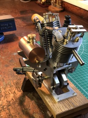

Hoglet V twin
The carb is an RC carb as well I bought it on Amazon sorry I can’t remember the details but I believe it has a .250 bore larger ones were available when I was looking.
Just as an aside, be aware that some RC carbs use seals, O-rings etc. that were intended for methanol based fuel & don't do well in gasoline environment if that's what you are running. This includes silicon fuel line too. I hope you get the ignition figured out, it looks like a great build.
You have to watch out for magnet polarity as in the sensor is only sensitive to either North or South. The side of the sensor is also critical for best operation.
This is how mine is mounted inside the 3D printed holder with the pull up resistor and LED to show activation. I filled that with void epoxy to keep the wires in the right place.
Here is the sensor tripping as the magnet rotates around.
And you can see here there is plenty of space to the sensor and the magnet is not that big.
I believe the one I'm using is the
Item 99K3101, 1/4" × 1/10" Rare-Earth Magnet
I realized the polarity of the magnet was important but I will try both sides of the hall sensor and see if that makes a difference. Thanks
