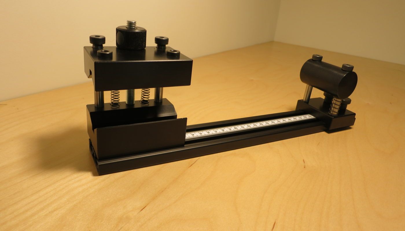

As for clamping the tubes with round dies vs v-blocks, I want to keep the tube axis passing through the same place on all sizes, so the round swappable dies are more work but preferred in this case. V-blocks are used in some tools like this like the one shown in the image below.

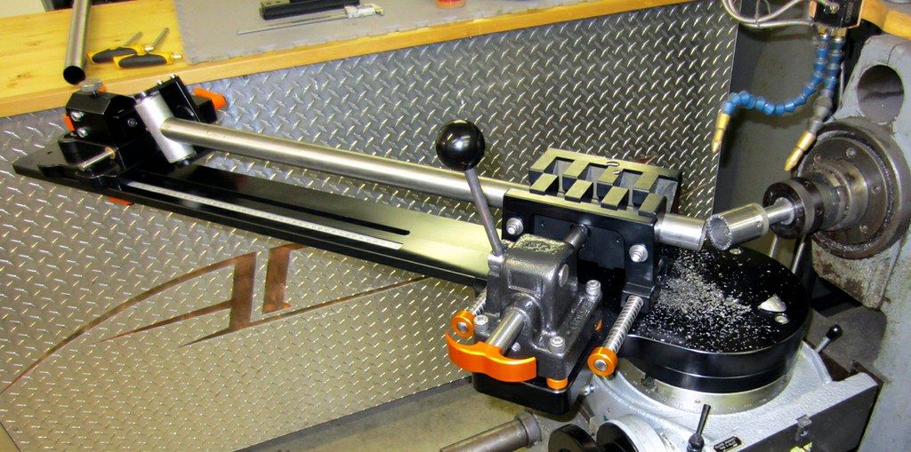

@Janger I am making a mitering fixture for tubing that would be welded into a roll-cage for example. The rotary table is rotating a tube in a different axis then you are thinking. Here is a similar tool that would otherwise cost USD$1500.

Interesting approach- how is this better than one of those drill press tube notch accessories? Is that a lathe holding the hole saw?

I think the picture above is a horizontal mill, mine will be mounted in a vertical mill. Functionally similar to those tube notchers, but those can be a bit of a pain to setup the angles and offsets. Those tube notchers also don't support the tube very well up where the mitering happens, so it can be challenging to miter thin wall tubing with those. Most of the tubing I'll be working with will be ~0.035" wall thickness.
The fixture I am building has a dummy tube on the opposite side of the tube being cut so you can pretty easily miter the tubes at the correct angles and length.

How much notching are you going to be doing exactly? I'm wondering just how much time you'll be saving operationally with a quick release clamp and hinge setup vs screws, while also considering the slop that might be inherent in a hinge. Most of the bike frame building tube notchers I've seen (other than the Anvil fixture you show) use screws or at least a thumb screw and pins to securely clamp the tube. It's a lot easier to drill and tap holes than installing a clamp and hinge though, so that might have something to do with it.
I like Sputnik tool's solution with a thumbwheel and pins (also, v-block for multiple size tubes).
Looked at your Harbour Freight link and suddenly I have a much better idea of what the OP is trying to do!
Ya, I'd be making my own fixture too.
Annular cutters on a mill would turn that job into a piece of cake once you make the right fixture.
