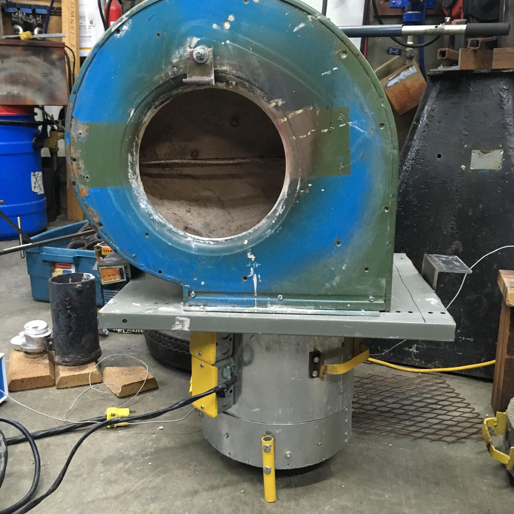

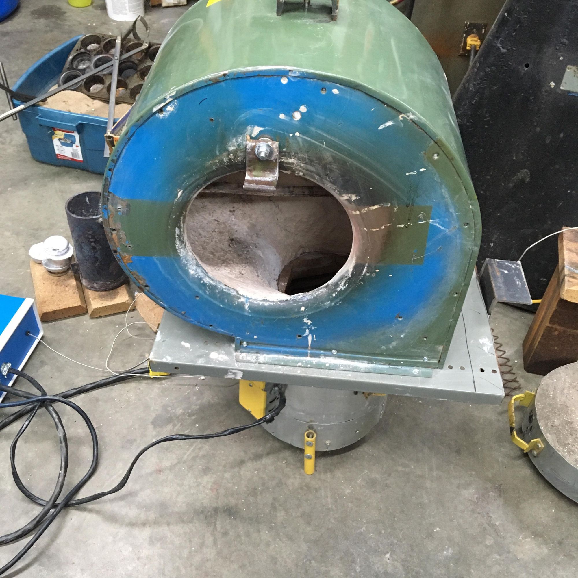

I rewired the furnance and then set out to build a 'hood' to sit on top. The idea is to have the heat radiate 'up' into a box, and have hooks/shelf etc. in there to put cans, knives and other on it. For this I repurposed an old HVAC squirrel fan (big sucker, 36" box). The shroud for the fan is shaped like a snail, so that became the start. I added a base, but a hole in the bottom.......

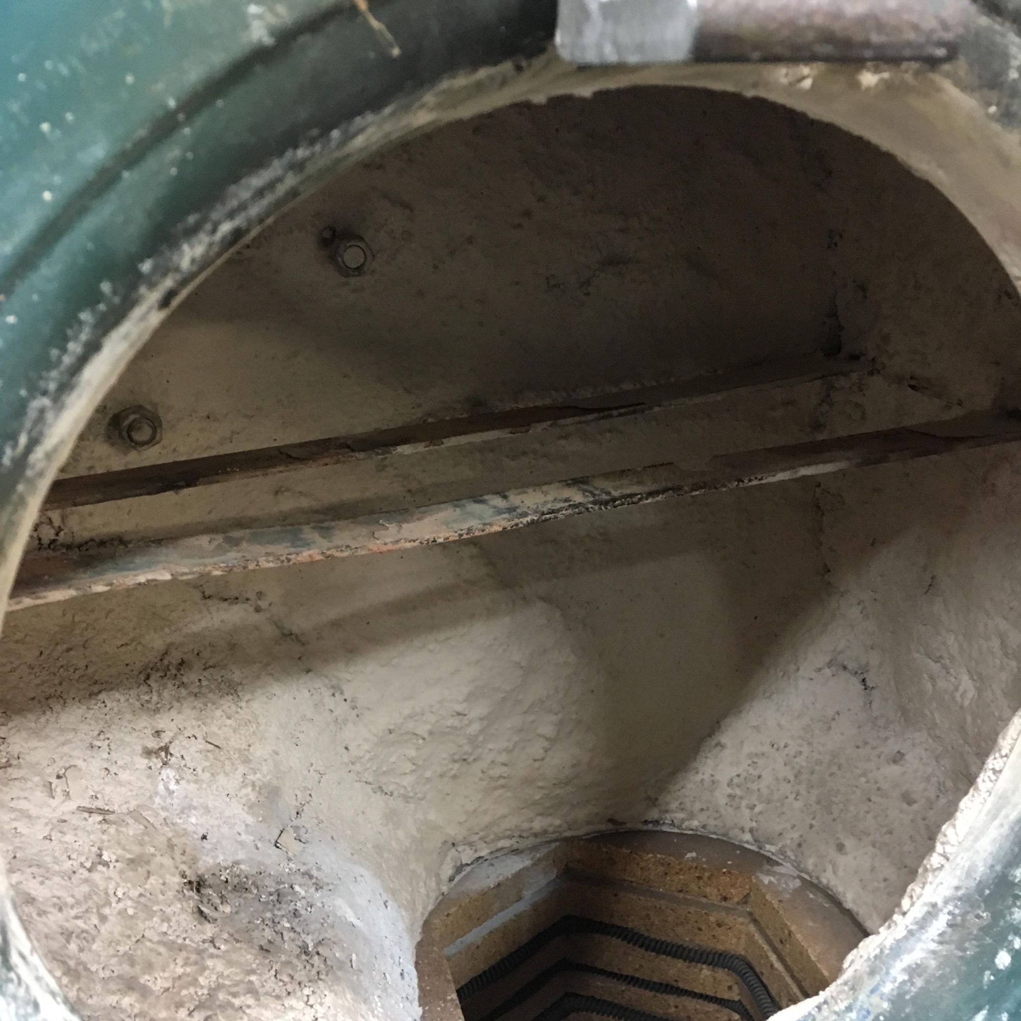

Ok, back to the design. This 'snail' shell wasn't going to have any heat source of it's own, will radiate from the furnace. I started with a 1" thick ceramic blanket lining, then ordered up some 'Rutland Refractory Cement' from Amazon (12.5 lb pail). Well, that works well, it dries hard and needs no curing. I ordered 3 pails (pricey, 42/pail), one arrived, two made it to calgary and then I got a refund from Amazon saying my product was damaged beyond repair. I suspect they dropped it.
Rather than order more, I decided to break into my cache of 3600 degree refractor (I have 3 50lb bags) which I was saving to do a cast iron furnance. This stuff is not as easy to work with (does not cure hard). I have to get creative and go about it in 3 batches to fight gravity. I cured each phase for 7 hours at 230C.
After that, I've always been curious about what the ITC-100HD product looks/feels like. Princess Auto sells it online and they had free shipping so I picked up a 'pint' for 70 bucks. Yikes. It is basically like pre-mixed grout, very sandy/gritty. You mix it 2:1 with water and they recommend 'spraying' it.
Warning: An electric wagner sprayer is NOT the tool you want........ what a gong show. Plugged in 0.2 seconds.
I ended up brushing it on (fairly thick) and put the whole pint into it. Then I fired that.
So if you're paying attention, that is steel shell, 1" ceramic, refactory top coat (1/4 to 1/2"), ITC-100.
I put the thermocouple in about 1/2 way up and fired it on Sunday. I will hit 500C, but it takes time. This is expensive. The furnace is 3" of refractory and it sinks a lot of heat. But once it is hot..... it is hot. I think the thermocouple is 1/3 less than what the bottom is. I'm normally not phased by heat in terms of 'danger instinct', but my skin on my arm started to peel like a bad sunburn after a session. Gotta rethink that.
Looking back I'll be doing a formal heat treat furnace build with brick/heating element etc. This is the only way to keep the heat. But the hood is awesome for the PLA burnout, and will be a great 'temper' oven after heat treat.
