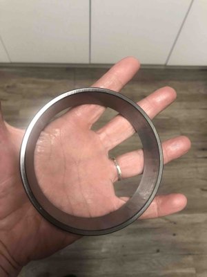

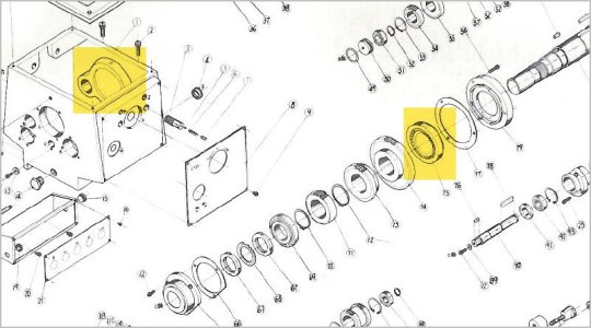

I got the new bearings and races for my 1440 rebuild today. Pretty excited as I can now start the headstock assembly.
Anyone have suggestions for getting the old races out?
And how about the new ones in? I'm thinking threaded rod and a couple of plates and the old races to pull the new ones in.
Any suggestions would be appreciated.

They are tapered roller bearings. Also used in the from hubs of car wheels, so I like won't wear them out in my life!

(110 mm OD)

Ah, so all the preload is from the spindle nut. I just did an account of replacing a taper bore roller bearing (taper on the shaft the inner race is drive up on) but that won't apply to yours.

So that's a bit bigger than I was expecting, lol.

If the manufacturer was nice there could be cut outs for the brass drift. If not, curse the engineer who spec it. If you can get some lip ,work your way around slowly so as not to cock it.. We have frequently had to resort to welding to shrink.

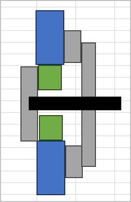

I've never done one, assume its this main spindle bearing? Does it remove towards the tailstock end? Wouldn't it be easier to make or scrounge a metal 'puck' or even a bar slightly under bearing OD & screw jack it out with standoff blocks - basically a bearing puller?
