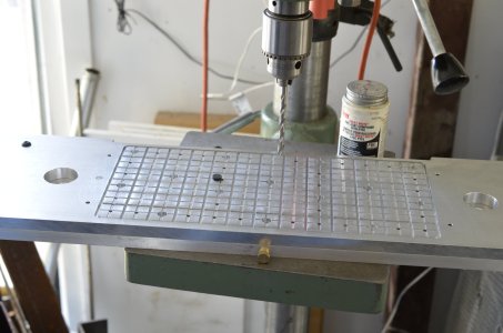

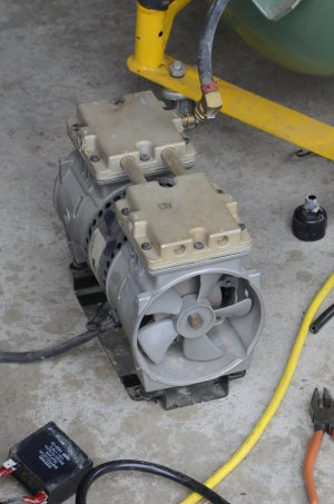

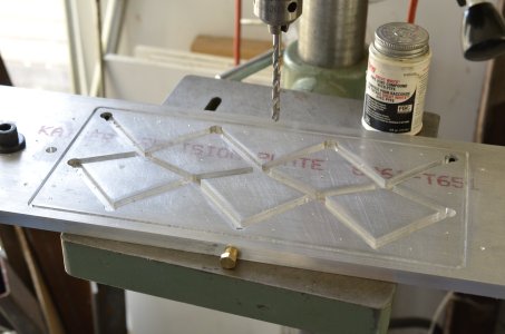

I've attached some photos of the vacuum plate that I put together some years ago using two pieces of 1/2-tooling plate clamped together with a gasket around the periphery. The bottom plate has slots to distribute the vacuum to the upper plate that actually holds the stock. Round 3mm gasket material seals the workpiece to the top plate.
