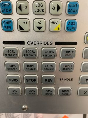

4. Use the jog mode and manually move the table and spindle using the MPG wheel. Trouble I've been having is turning on the spindle while in JOG mode. It seems I need one line of gcode to get it started. The code turn on and set the spindle RPM:
M03 S1200; <- turn on the spindle to 1200rpm
Here I am assuming there is a tool in the spindle, the coordinate system is set (say G54), and all other modal commands are off.
This program turns on the spindle. To use put it in single step mode, press cycle start and the spindle turns on. Now you can use JOG to move the axis AND start the spindle with the FWD STOP REV buttons. (The doors have to be shut). Without the GCode M03 S1200 the spindle won't turn on - I guess because the machine does not know what speed to run the spindle. So this could be handy for example to square up some stock or drill a hole. Like on a manual mill I have to turn the MPG wheel through all the required operations so there is no walking away while the mill works. But hey no programming and there is DRO read out for positioning. :cool:

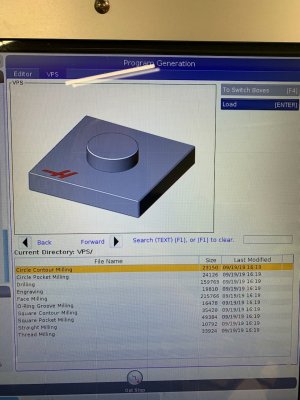

I do use the wizards on my new generation control but I don't know that older machines have those wizards? Below are the wizards available. And also the buttons for spindle control. I guess you don't use or can't use wizards since you didn't mention it.

And similar to Dan, I tool change with T## M6 G43 and have done an S1000 M3 at some point. After that the spindle ON/OFF button on the pendant or the screen start/stop the spindle at the last set speed.
Either the keyboard or the MPG is used for traversing. I agree there are a number of GCode commands to remember. But for cleaning up an edge it's usually easier to tell it G01 X2.0 F20 and then when it's done jog Y in a bit using the MPG and then since it remembers G01 just X0 to go back and mill again.
Or move Y so the cutter clears the work. G0 X0. Then move, with the MPG to the new cutting depth. G01 X2.0
And when done either the M5 to turn off the spindle, the button on the screen to turn off the spindle or the button the Pendant. Whatever is handy.
