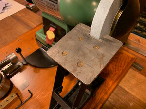

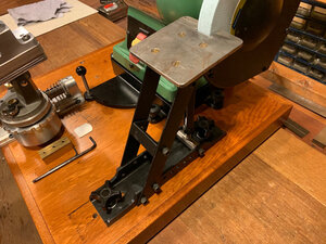

In my shop things tend to evolve and morph as I discover new ideas or skills. The grinding station is no exception and really just started out as a way to sharpen HSS lathe tools. Coming from a woodworking background I like a hollow grind, and that typically requires a solid tool rest for consistency. Most built-in grinder rests are somewhat flexy owing to flimsy material and single-point mounting, at least on smaller grinders anyway. And they usually rely on a thumbscrew or two that is always painfully small and impossible to tighten. I dispatched with both of those concepts and built a rest that stands directly off a solid base platform.
The toolrest table itself is 3-1/2” x 3-1/2” only because I happened to have a small stack of pieces as salvage from a local stove factory. It’s 3/16” thick and has a notch to clear the wheel but only by a sixteenth or so on either side. It’s also easily exchanged for other versions if needed although I have yet to require that.

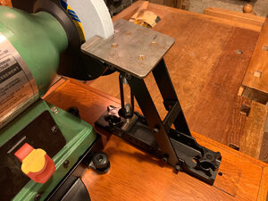

Angle adjustment is furnished by pitching the leading edge (closest to the wheel) up or down relative to a fixed hinge at the rear. The elevation changes are obtained by using a turnbuckle which raises and lowers cleanly and very controllably, but also holds the position so there’s no need for a locking nut or secondary action. One hand can hold the bit or reference angle, the other adjusts the table with the turnbuckle, and that’s it, grind. Fore and aft movement (towards or away from the wheel) is accomplished with two jig-fixture knobs threaded into the base platform through slots in the base channel.
The remainder of the “standard rest” was in anticipation of having to adjust positioning more than I actually have to. Other than table angle and wheel proximity, the rest stays configured in one position all the time. One thing to understand about this concept is that it does away with what some people regard as “the safety feature” of a single-pivot rest. If they jam a bit between the table and the wheel, they want the table to swing down and away and not continue to jam. Mine will not do that although I have yet to ever get anything jammed in it either. Your call.

Took me a while to figure why the whole test didn’t want to shift position when the turnbuckle was adjusted.
Then I spied two cap screws on each side of the base.

Yes, all steel for the standard rest, just regular A36 hot rolled channel and flat bar. I didn’t have a milling machine back then so had to stick with off-the-rack material.

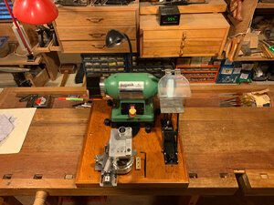

My bench grinder is a smaller HP model & it really needs to be raised to align properly. Is the black base under your grinder part part of your mods to allow the jigs to function, or the way the grinder came?
The black plinth is my own concoction. At first it was just a rectangular block shape to raise the grinder about 1-1/2” to work with the standard rest (I wanted a certain size of turnbuckle to be finger friendly so I had to raise the motor a bit to meet that criterion and still allow me to stay on centreline of the wheel). Once I decided to swivel the whole unit for the second milling cutter head I built a new plinth that incorporated the quadrant shape and ears for the fixture knobs. It’s nothing special, just MDF glued up and painted.
