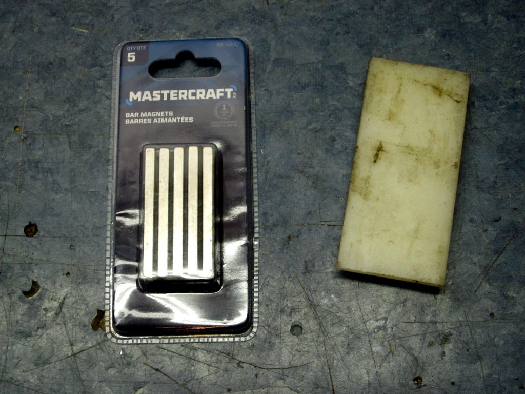

I searched my local hick town for magnets and at Canadian Tire I found a five pack of rare earth magnets.
I made a housing to attach them to the bottom of the skid plate. I will update how well it works in the near future.
The magnets and a piece of plastic I had in my scrap metal pile.

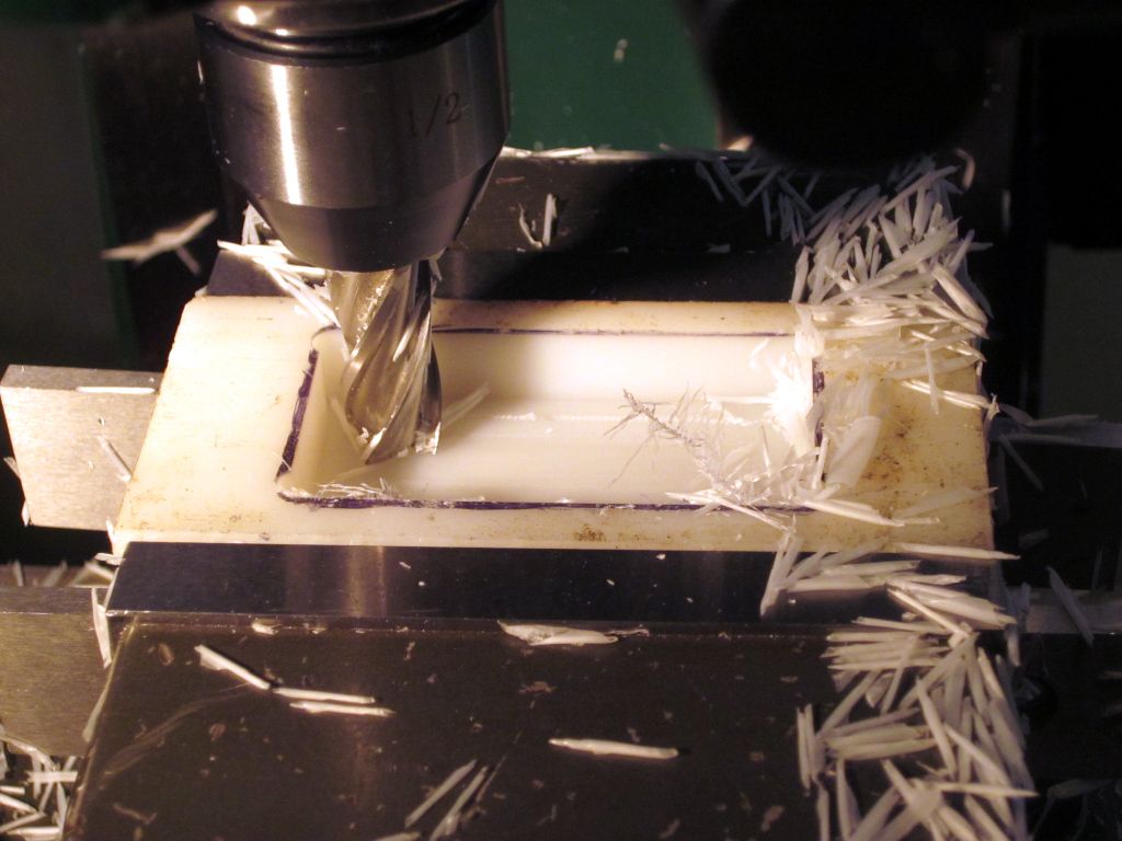

Milling the plastic housing.

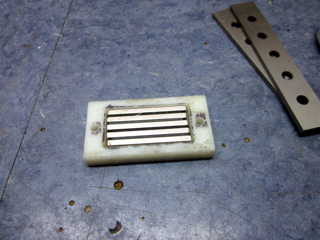

The finished housing. Any steel getting within three inches is immediate sucked into the magnets.

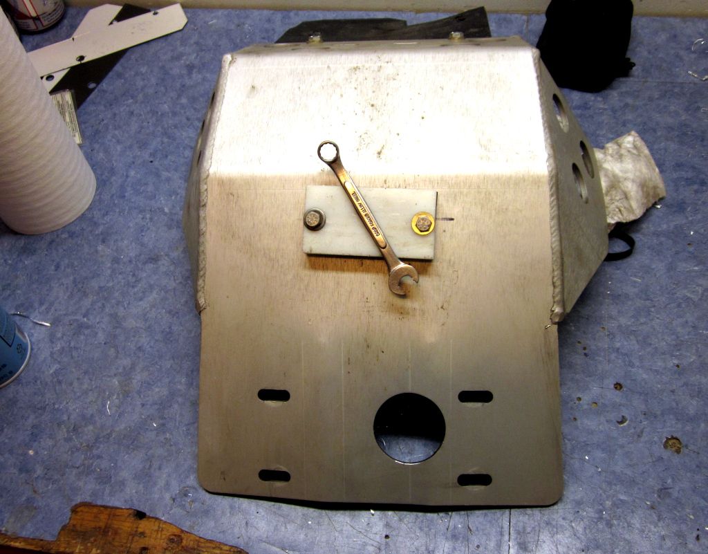

I drilled and bolted it to the skid plate. Its crooked but no one will know.
