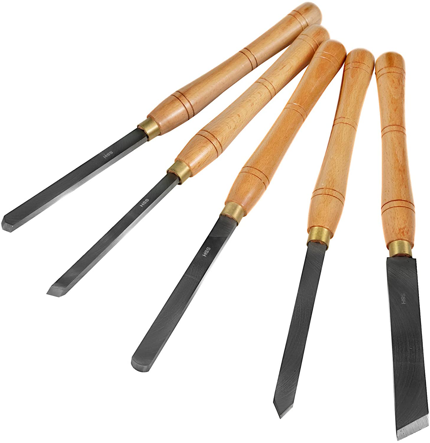

You are using that set of carving tools for woodturning? They are not really designed for such.
Woodturning tools usually have a longer shank and handle so you have good leverage. Also the shank does not narrow down ahead of the ferrule--the carving tools could bend at that spot. Less expensive woodturning tools are still made of HSS. That lets you re-sharpen them quickly on a grinder without worrying about drawing the temper out of the (carbon) steel.
Here is a set as an example (no recommendation intended):
https://www.amazon.ca/Mophorn-Cutti...=wood+turning+tool+set&qid=1629203272&sr=8-10
(I have a wood lathe and have done a little turning but I'm far from an expert.)
@trlvn Craig I hummed and hawed over this for a while, and my final decision was based on seeing pictures of them being used on a wood lathe, I wanted to get something to get me started and my plan was to see how these work and for sure for roughing down squares or other roughing work and I will probably eventually buy a bigger more proper set if I feel I want to do more of it (which i think i will) and I have found that once its round they work well for doing detail. The other plus is now I can experiment with making an handle and maybe make something like George has.
