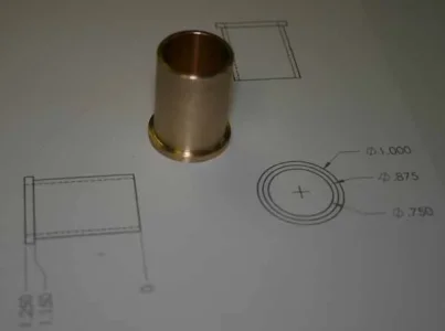

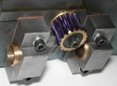

Your project kind of reminds me of when I remedied my 14x40 lathe power feed rod bracket (which bridges the worm gear). The stock casting one was an ill fitting cast iron POS. I think the idea of cast iron as a bearing surface is the carbon filled porosity or something. Which is fine & good as long as perfectly aligned & minimal side load. When I machined new steel blocks from steel, I sized the holes to incorporate bronze bushings which are a nice slide fit on the rotating rod. The bushings can be removed & replaced if they wear. Bronze on steel is a happy combination with oil lubrication. It never ran smoother. Looks like you may have an oil port in your casting? If so that would have to be incorporated into the bushing but easy to do.
Just an idea to ponder. Your Graziano is probably better aligned & assembled than my Taiwanizo which was way out of whack from the factory floor. But just saying pay attention to the fit post-fixing so its not bending or rubbing the rod even a little bit. Adverse effects can show up in machining finish. Or worse, can lead to bigger headaches down the road trying to remedy or replace a more obscure rod/leadscrew if it loses the friction battle with the (easier to fix) hole in a plate.

Ah! Cancel that recommendation then. You have a more sophisticated machine. The reason lathes like mine cost less is they eliminate some superfluous components like bushings & bearings... LOL.
Looking at your pics closer I now see a ledge, maybe like a stop for a bushing/bearing? I naively assumed it was a plain 'ol hole like mine.

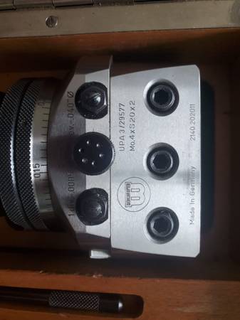

I have a (Ahem) busy bee chinesium boring head. I also have a thomas skinner one that Bert paid 4X the price for. They are identical in form and function.
Now the rub: (pun intended) You should never take a cut more than a small one - for instance one or 2 thou. So how do you get all that brass our of the hole? well, I usually mill things out to ten thou or so and take the rest in small cuts; -- or -- you can hole saw brass with a wood working hole saw to rough out the hole. I have been known to use a jewelers' saw to rough out before boring. roatary table? there you go.
A lot of machining, so I have found out, is also hand work.
anyway, if you stick to the 'shallow cuts' rule, then any boring head will work fine. Of course I am looking for a cheap, used Wolhapter boring head. But we all dream of that sort of idyllic relationship...
When boring an irregular hole like you have, the impacts are really hard on your bar, boring head and bearings. someday ask me how I found out. Not too pretty.
